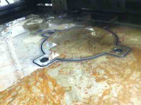

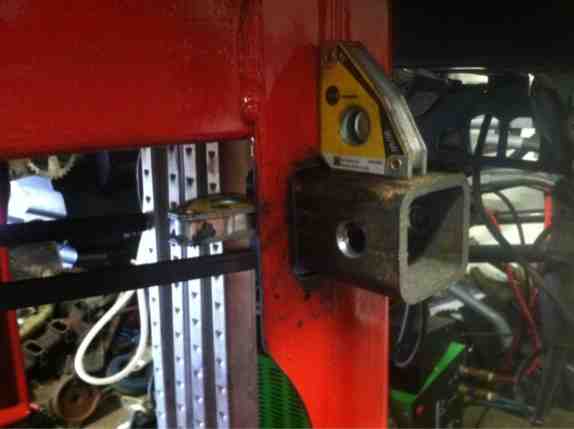

    Started building accessory ports
    LONGEVITY 250EX Tig
    MILLER 211 mig w/spool gun
    SMITHY 1324 mill/lathe
    60 gal. 7.5 hp air compressor
