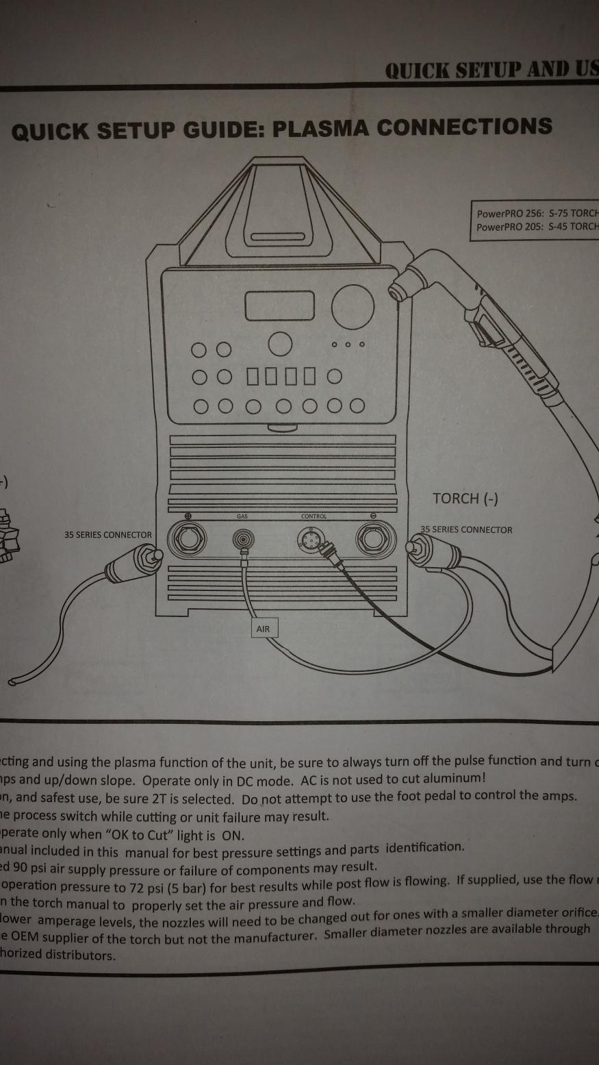

    My plasma torch was obviously used before it was sent to me. The consumable has been burned. When I tried to hook up the plasma cutter and operate it, I noticed: 1. the torch lead has an extra red wire that I can't find any info on, and it doesn't have an obvious place to hook up. 2. the torch will not fire unless I touch it to the metal directly. Pressing the trigger does nothing, but releasing it gives a short blast of air. It's basically a scratch start plasma cutter? The stand off will not allow contact, so it had to be removed to work at all. What gives? I'm showing the pic so you can see the mysterious red wire.

    It attaches to the pilot arc post on the front of the machine... loosen the black plastic cap. The machines are tested before shipping.

    Reading the manual first too would likely help calm your fears and give greater understanding. http://www.everlastgenerators.com/si...ies%202013.pdf
    There is a black plastic coated thumb screw which says pilot that is sticking out the front of your unit which is the pilot arc.
    Also all torches are tested before leaving the factory. The torch isn't used if that is what you were thinking.
    If you have a true 256S then that torch should be an S75, not an A81. Check the handle to confirm as it says what it is on the side.

    You're right, the terminal is right there for the red wire. I hooked up the machine in very low light last night and totally overlooked it. Thanks for the response.
    As far as the torch being tested, the tip looked to be extremely well tested. Not simply turned on for a moment and then packed up. Works perfectly now however, thanks again.

    Wished the manual that came with mine looked like the one you linked. It WOULD have made it a little easier. It did come with the S75 torch tho.
