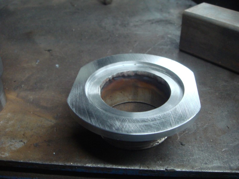

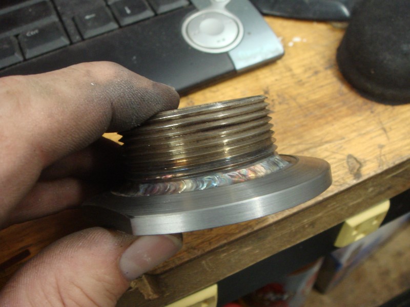

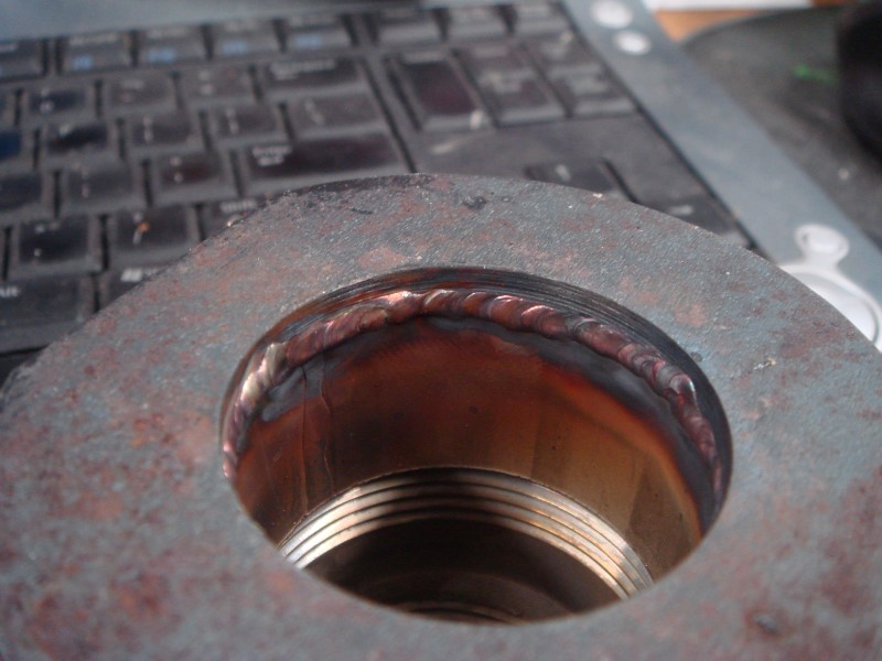

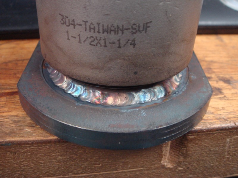

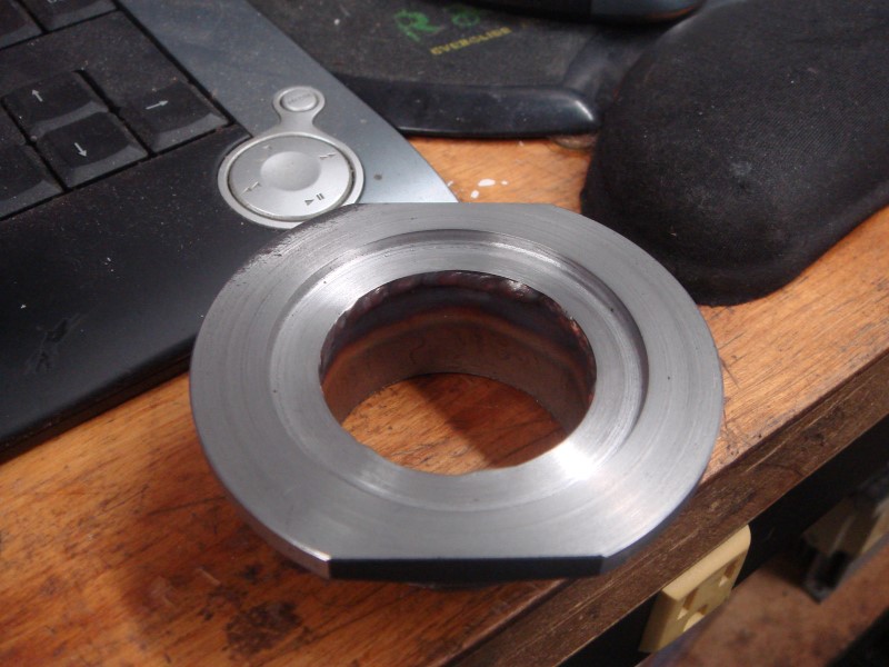

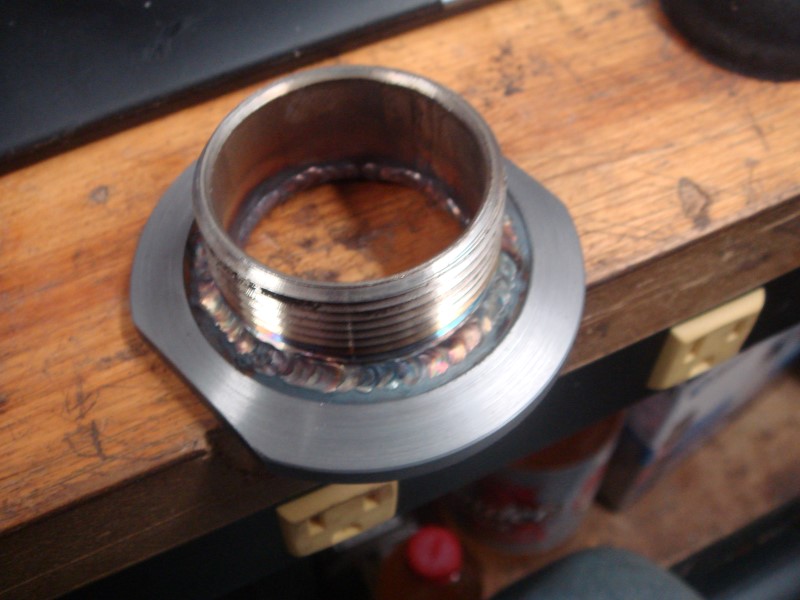

    I needed a part for a project, but it was backordered with no ETA. Time to make a substitute.
    I had a stainless pipe nipple to use for one part, but only carbon steel for the other. Weld the two with TIG and 309, then put it in a coupling to machine it to size.

    And here is my solution from parts.
ID:	12856 Click image for larger version.
ID:	12857 Click image for larger version.
ID:	12858 Click image for larger version.
ID:	12859 Click image for larger version.
ID:	12860 Click image for larger version.
