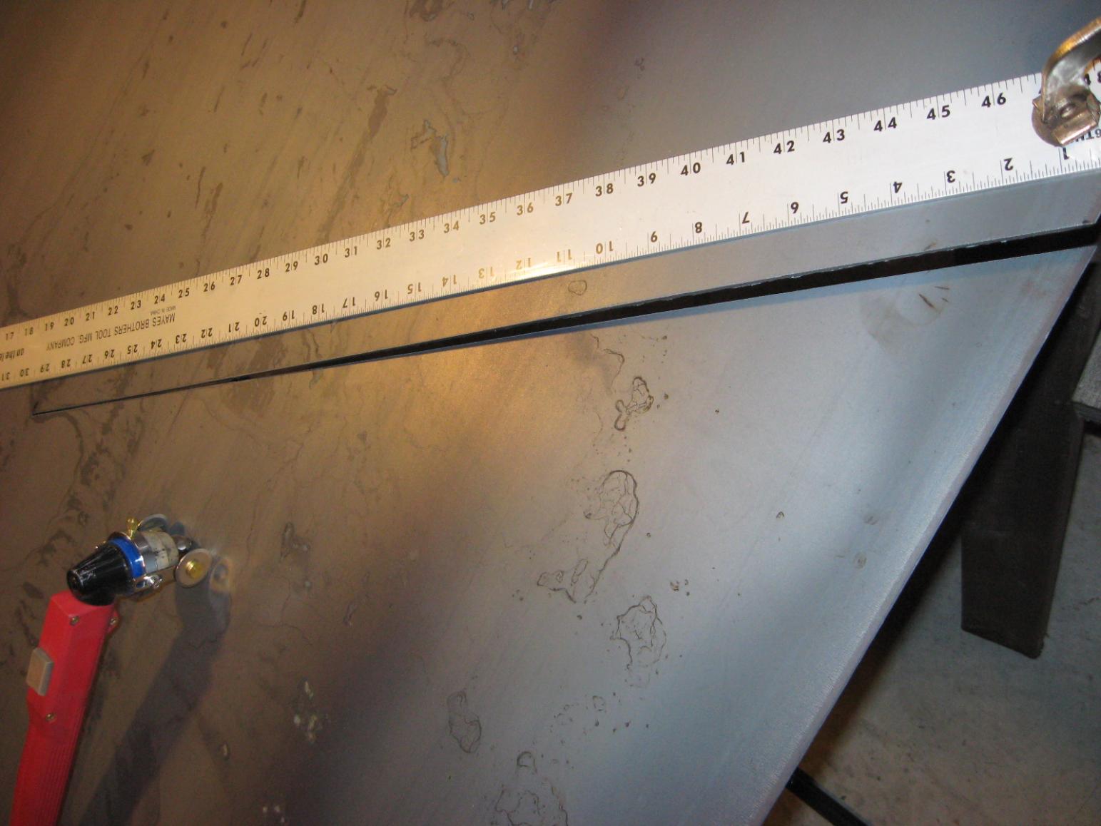

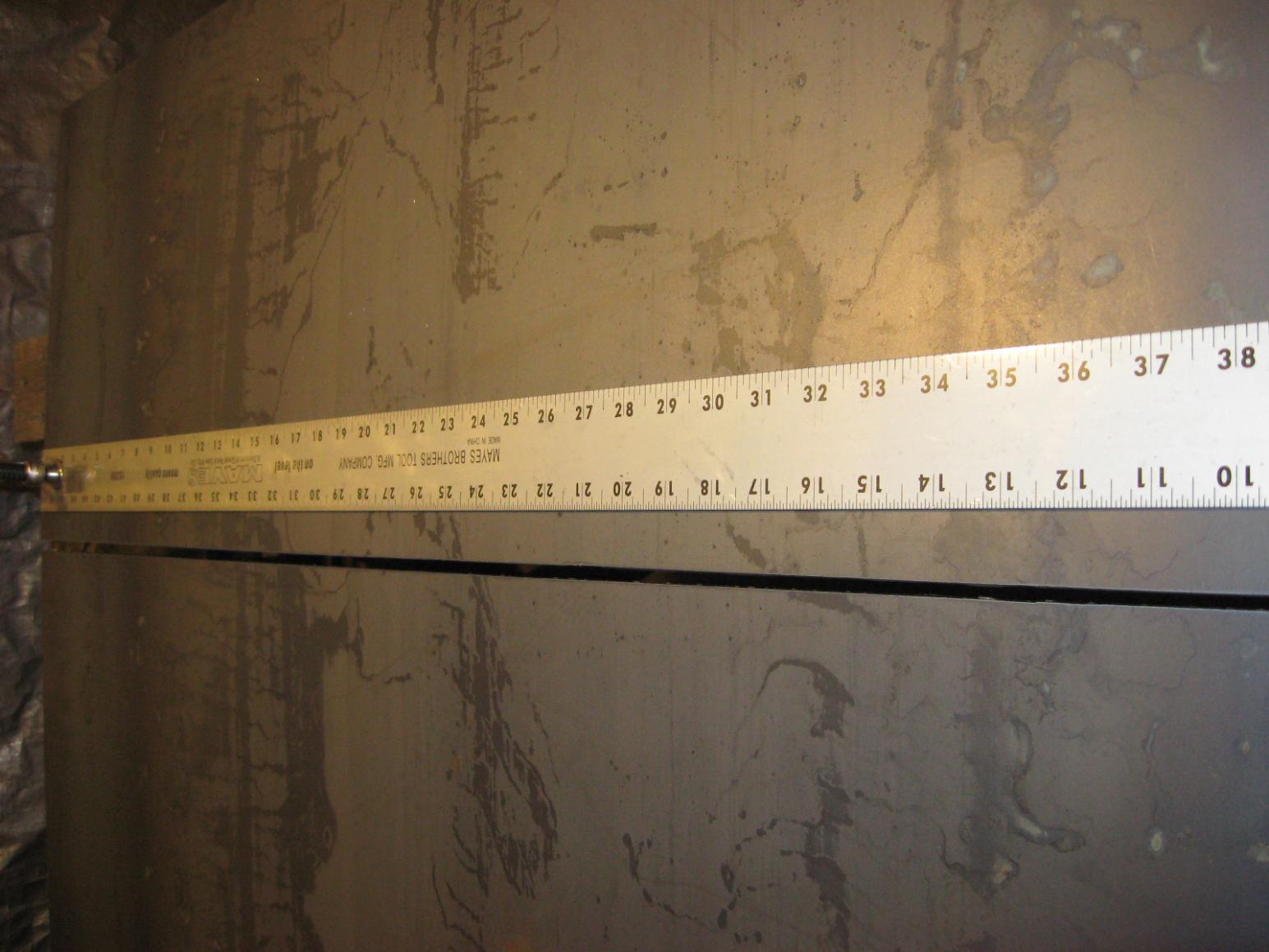

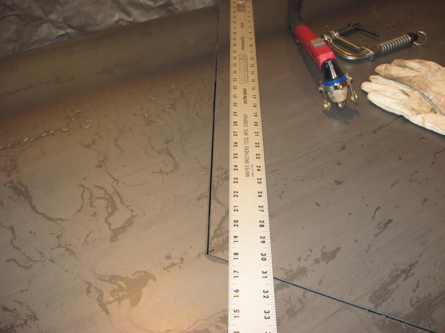

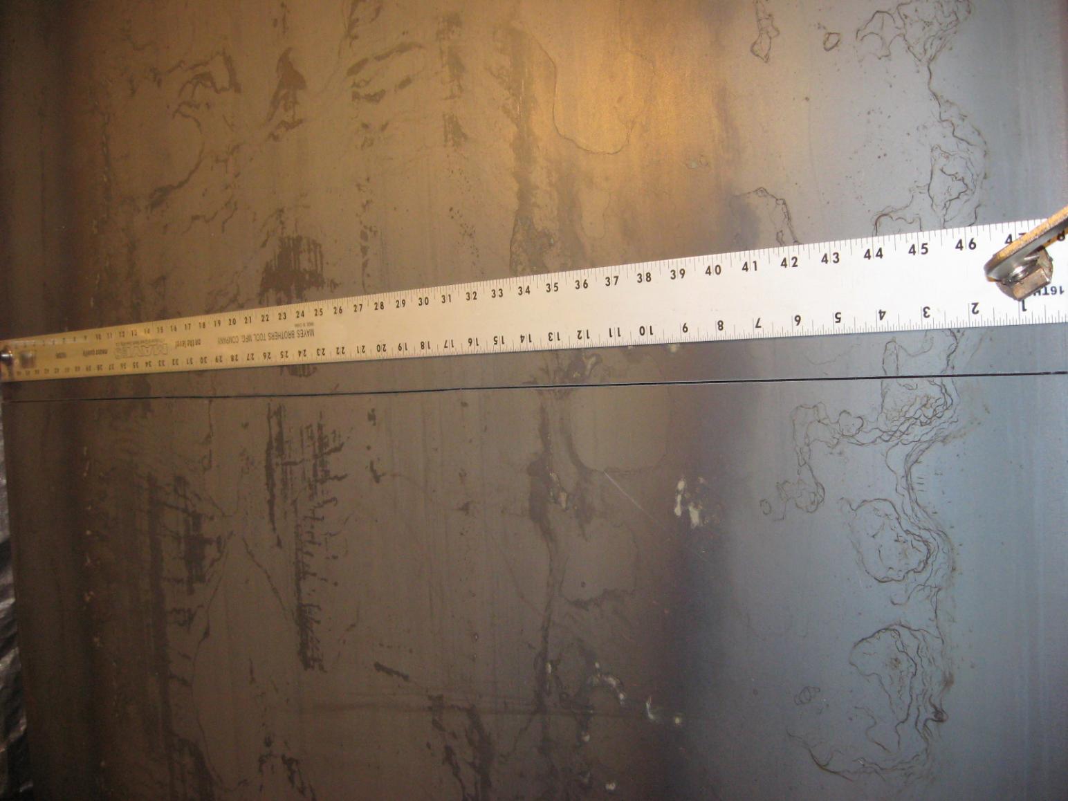

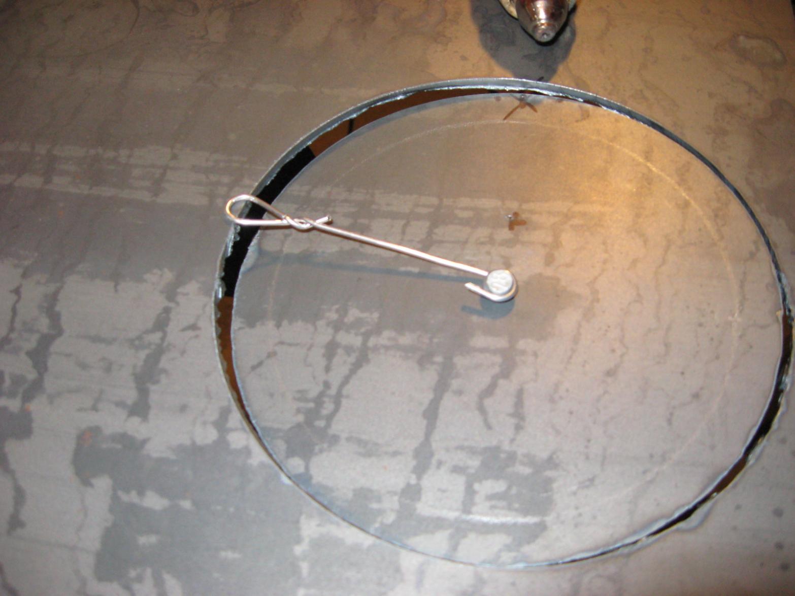

    If you currently own or have owned one let's hear your experience good, bad or ugly. Consumable life, cut quality, overall build. Maybe some pics of projects done with your powerplasma.
    I have owned a PP60 with a P80 torch (High Freq) for several years and it's been flawless.
    Consumable life has been about one set per year for my more than average hobby work.
    Here are some pictures of cuts in 11ga cold roll and a project with 3 pieces cut from 1/4 x 3 cold roll steel. http://www.everlastgenerators.com/fo...-Plasma-Cutter

    A good air drier like the Motor Guard M60 is a must have for clean cuts and long consumable life.
    Nice clean cuts!
