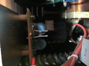

    I've been trying to use my 225lx with the 2t & 4t switch. I am having trouble getting the welder to fire off. It seems that I have to touch the metal before it will start welding. It is acting like there is no high frequency start.
    Do you hear any HF buzzing from inside it? Have you checked the point gap?
    Yes it does have a buzzing sound. How do I check the points?
    You can get the exact gap from support, but most are around .030" so that will put you in the ballpark. I haven't seen any photos of the inside of that model, but the points shouldn't be too hard to find. Before you pull the covers off, you might be able to see some arcing from the points through the vent slots, to give you a better idea of where to look. Maybe try a dark room, to help see. Of course if the gap is way out you might not see any spark. You can find some pics of the 250ex points on the forum, to give you an idea of what to look for.
    I'm guessing these are the points, I took some fine grit sand paper and cleaned them up. I have not had a chance to use the welder.
