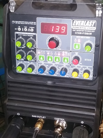

    Post a clear picture of the welder so we can see the settings, please.

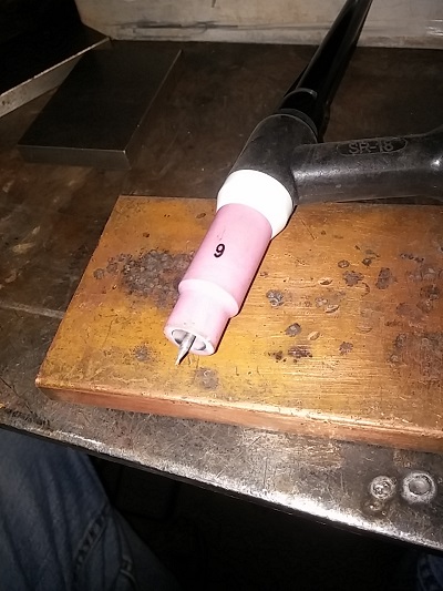

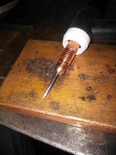

    And the collet and weld/material.
    I don't think I need to preface this with 'I'm not a welder, but' these are the settings I used as well as others. I tried using the torch trigger, both 2T and 4T, and the foot pedal 2T only.

    Verify that argon is flowing out of the cup.
    Have the tungsten about 1/8" from the material to be welded.
    Definitely is argon and it's 'clean' argon, I was using it with the last welder and it worked well. The old welder was a very basic Chinese 200 amp DC welder and it worked. I was thinking that I had something wrong but what is confusing to me is that it works very well on the copper but almost not at all on my part. The other thing that I found strange was that the HF start was almost like a 1920s or 30s movie where they had 20 foot lightning bolts. One time when it started there was a white smoke that came out of the torch when I tried to initiate an arc as well. Is it possible the torch is NG?
    Anything is possible but I haven't seen a bad torch on one of these. I'm gonna have to leave this one to the tech support guys but I'm sure it'll be something simple.
