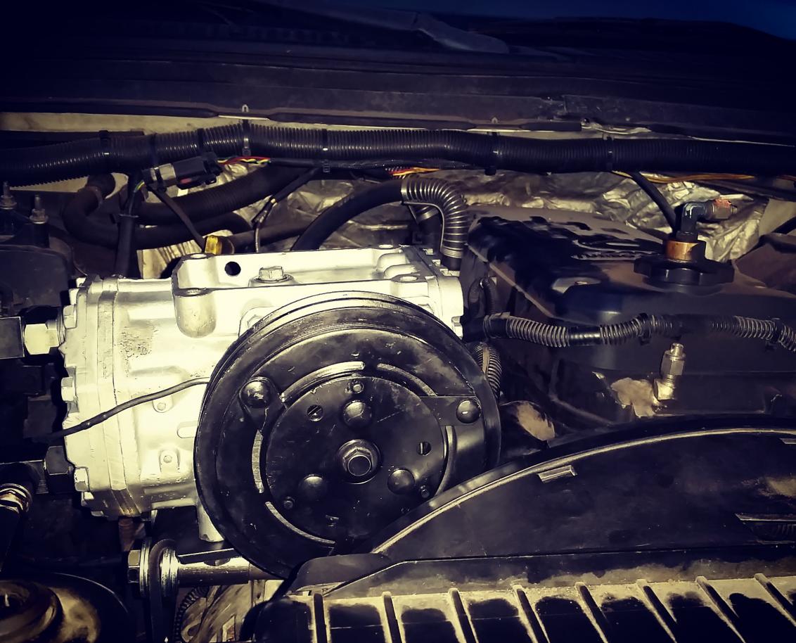

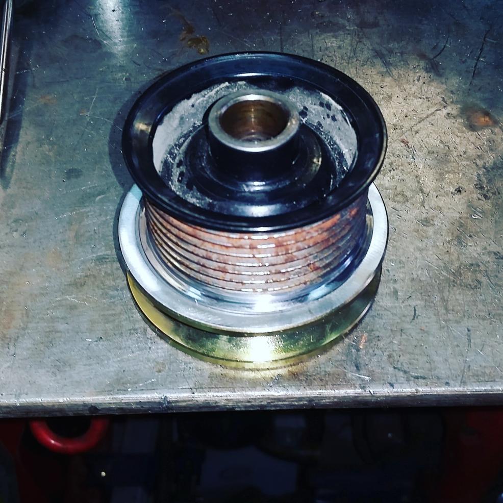

    Started building this mount for my Cummins powered f250 that uses the ford altClick image for larger version.

    Swapping accessories is always fun. Looks like a good solution. How was the runout on the finished part?

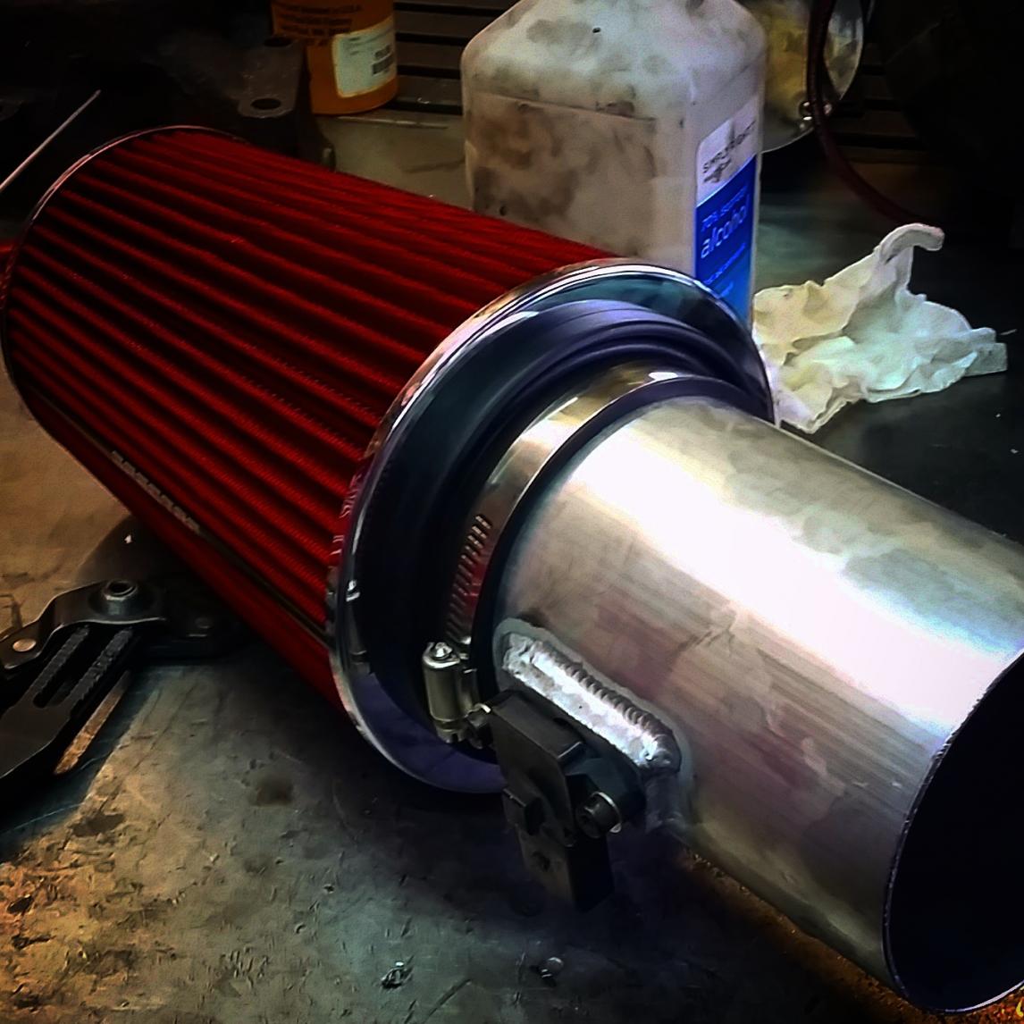

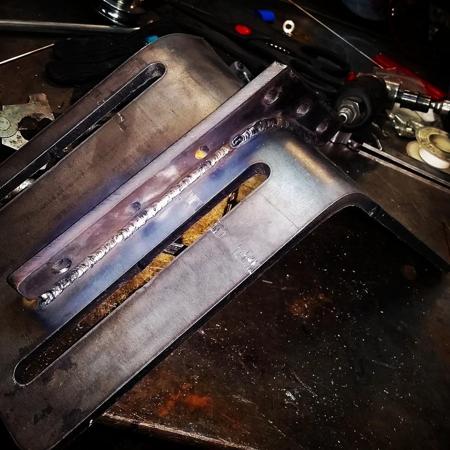

    Run out wasn't to bad , about .010 , here is some progress Click image for larger version.

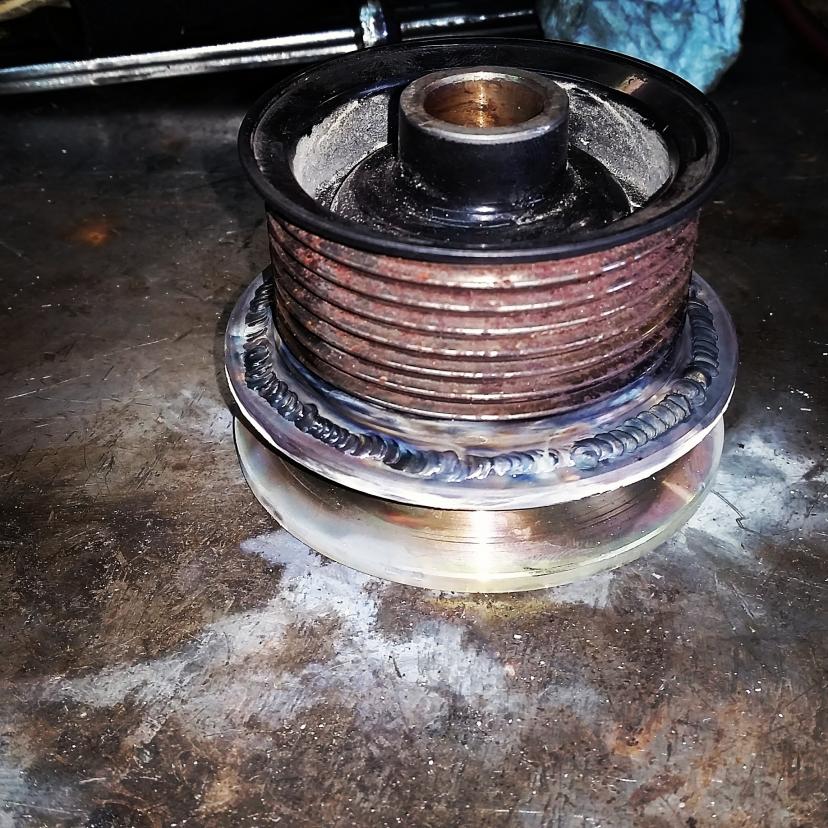

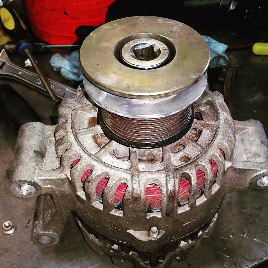

ID:	13112Click image for larger version.
    Sent from my SM-G900V using Tapatalk

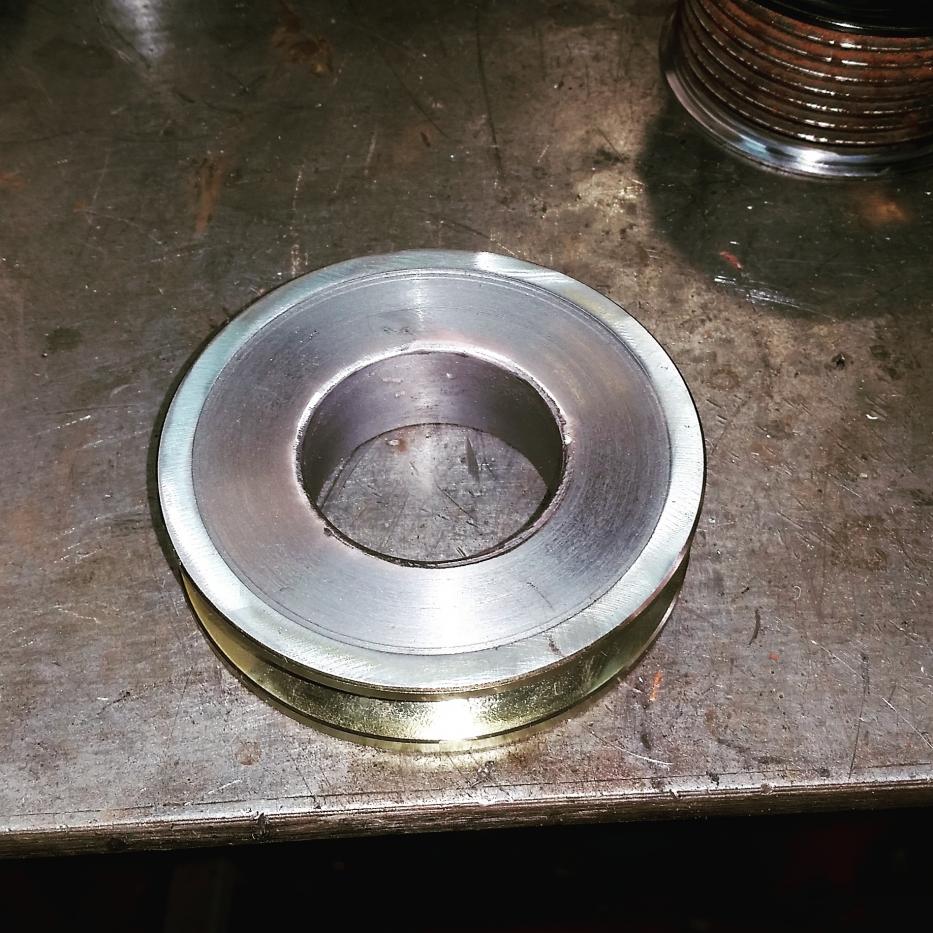

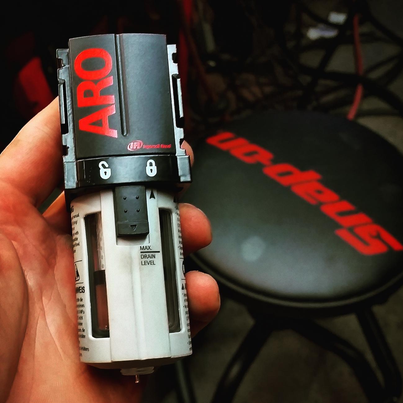

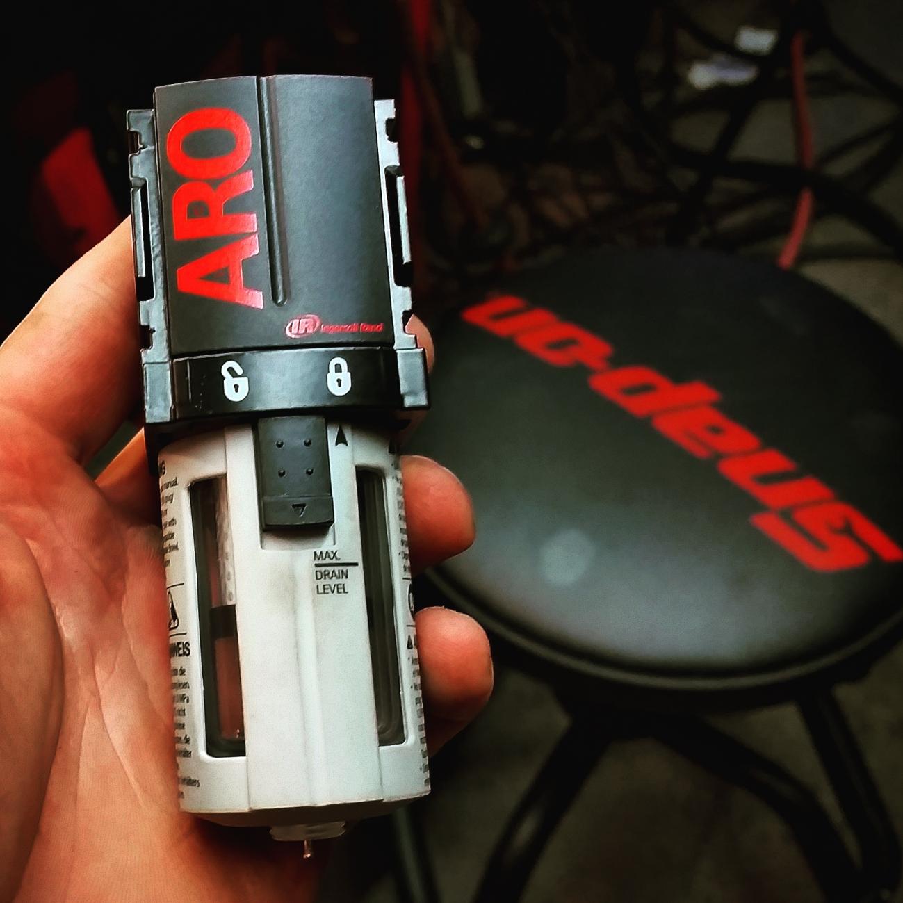

ID:	13114Click image for larger version.

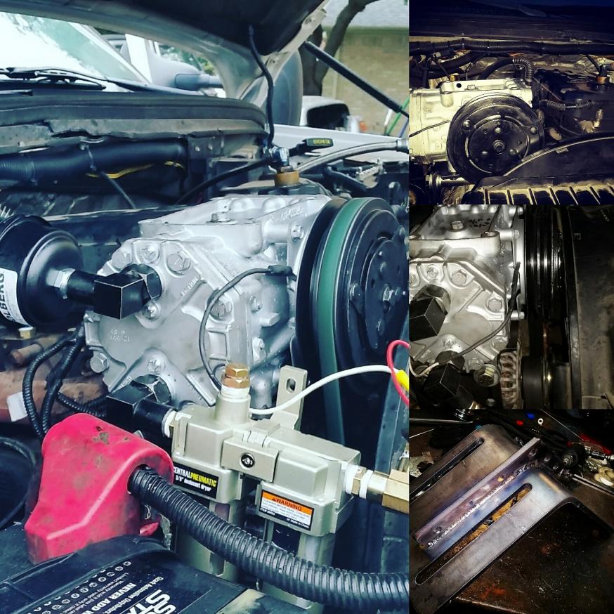

ID:	13115I am switching to thins Ingersoll Rand part with auto drain to return oil back to the york
