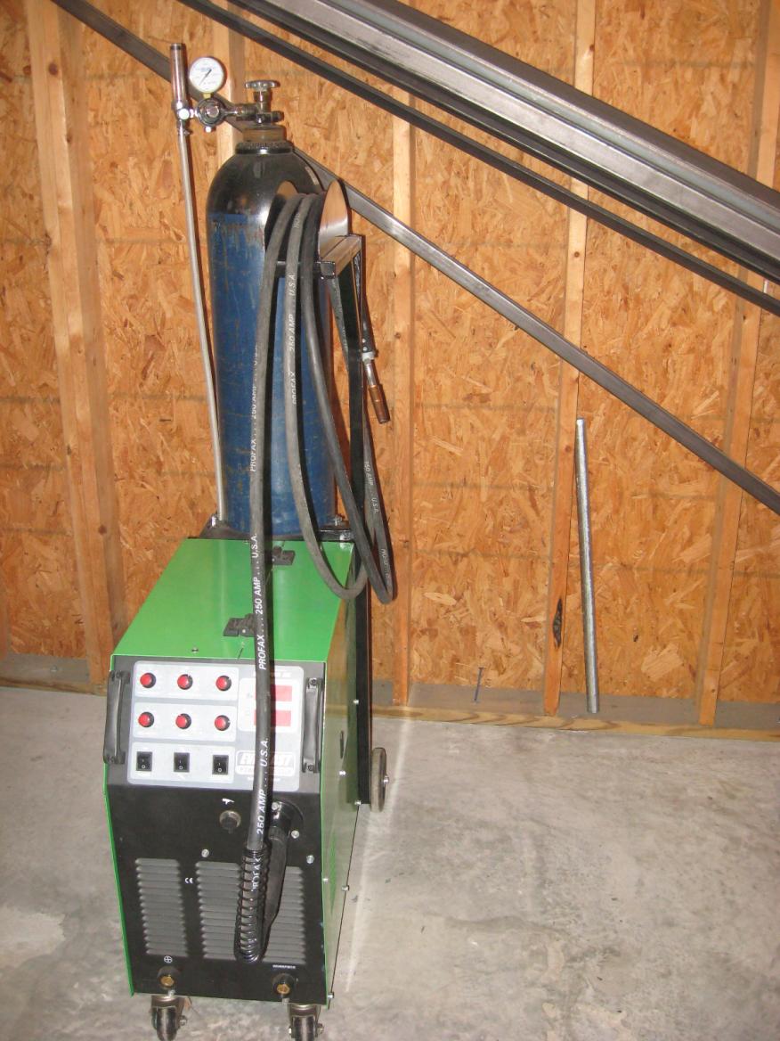

    I found a pic of the front. I added the cable hanger after I switched to a 20' profax gun.
    What did the profax set you back and where did you pick it up (if you don't mind sharing). We use spool guns for the longer cable, might be worth a look for us. Came with the euro connecter too (plug and play)?
    Plug and play but I later switched the front end parts to screw on 23 style. Looks like weldfabulous.com has a good deal on them. The HD version may come with the 23 style nozzle. I bought mine in 2011 so the price may be higher now.

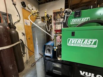

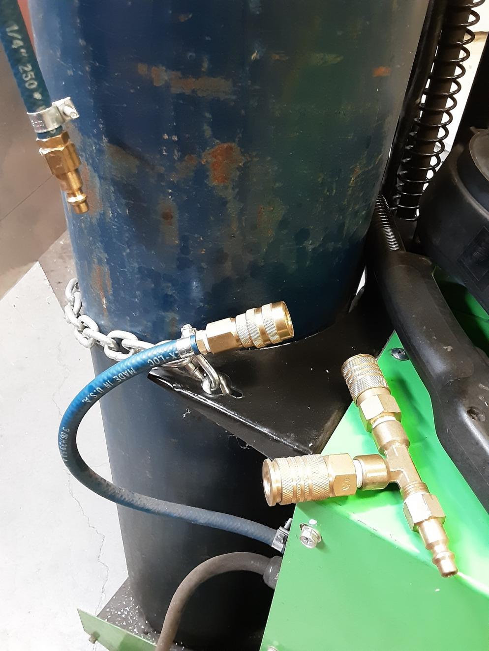

    I still blend the C25 on my MIG machine with pure argon from my TIG cart through a tee fitting with regular 1/4" air hose quick couplings when I need more than a 75% argon mix. I don't want to buy a third tank for what little I would use it.

    I went well overboard to short arc and spray with a Miller gas mixer and associated regulators. It seems to work really well but I should have just got the C18 gas and been done with it.
