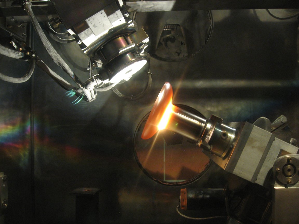

    The electron gun is upper left. The hot thing is a half of a single cell 1492MHz superconducting cavity. This operation was an experiment in remelting the cavity inner surface with the electron beam circular raster and under focused. This is Niobium - melting temperature is 4474° F.

    Very interesting. To get an idea of scale, what size is the 3 jaw chuck on that positioner?

    The chuck you see is one of five on a gear driven 'multi chuck' set-up for doing multiple welds on one chamber pump down. They are 5" chucks. The cavity in the photo is Ø8.1" on the equator (large diameter). The cells are deep drawn from discs cut from 1/8" sheet then machined and welded either to a beam tube (as in the photo) or to the iris of another half cell to begin the fabrication of a multi-cell cavity - they then become quite complex depending on the design and purpose.
    The lab is quite a place...We are one of very few in the world that has the capability to fabricate these superconducting cavities. I'm doing welds for many other labs including welds for components of the Relativistic Heavy Ion Collider at CERN in France. I will send a link to Jefferson Lab.
