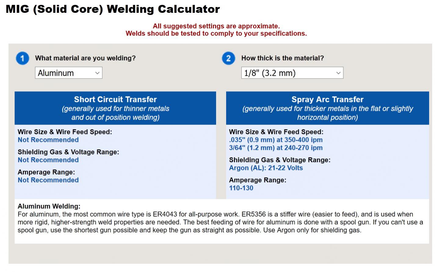

    You need to help me out. Unless I'm missing something it takes less power to spray thinner wire. So, if I can spray 3/64" and .035 wire, the reason I can't spray .030" is because I can't get the wire speed fast enough. And without faster wire speed there's not enough amperage to put the wire into spray mode. As the wire speed increases, the "short circuiting of the wire to the base metal happens faster and faster, raising the amperage, but without this happening fast enough the amperage doesn't become large enough. If this is incorrect, please tell me where.

    You got it. To spray .030" that wire would be flying. Something like 500+ ipm would be required. There are formulas to calculate amps and wire speed. Stickout also affects it to some extent. Total weld power is amps times volts, so even if one is high enough, the machine may not be able to keep both in the range you need, when pushed to the max. It's never a good idea to run a machine at it's redline, if you expect it to last.
    Here is an example chart for steel wire, aluminum is about double as I recall.
