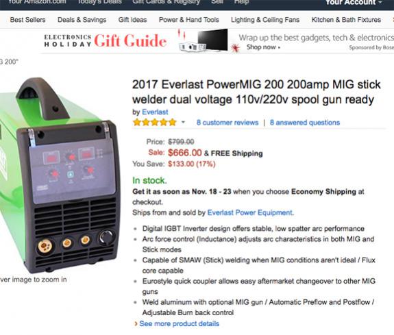

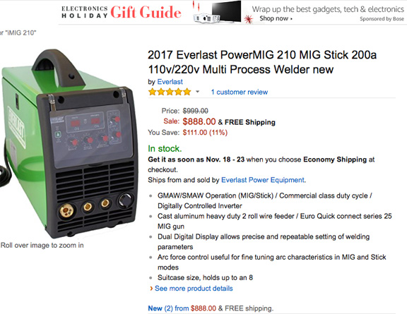

    I believe the iMIG205 and 210 are identical in specs and price, so the 205 is now the 210. But there's no pulse for either unit. I think you have to step up to the 251Si to get an Everlast MIG-Pulse, which also has TIG with high-frequency arc starts, which puts it in a class of its own.
    But, yeah, the iMIG 200 seems like a sweet value for a 200 amp MIG unit that has inductance and burn back adjustment. And it seems to be on sale via Amazon right now, at $666 and free shipping, with favorable Amazon reviews. The 200 amp range begins at 25 amps.
    The iMIG 210 has a better duty cycle than the iMIG 200. Othewise, I don't see a lot of difference. The 210 is also on sale right now via Amazon, at $888 and free shipping. The 210 is newer, and has only limited Amazon feedback so far, but, of course, its quite good. The 210 amp range begins at 30 amps.
    So, you undoubtedly won't go wrong with either of these, but the 251Si looks the most interesting to me, as it can undoubtedly go into spray arc transfer with the right gas, and the Pulse feature probably makes it nicer in any position welding.

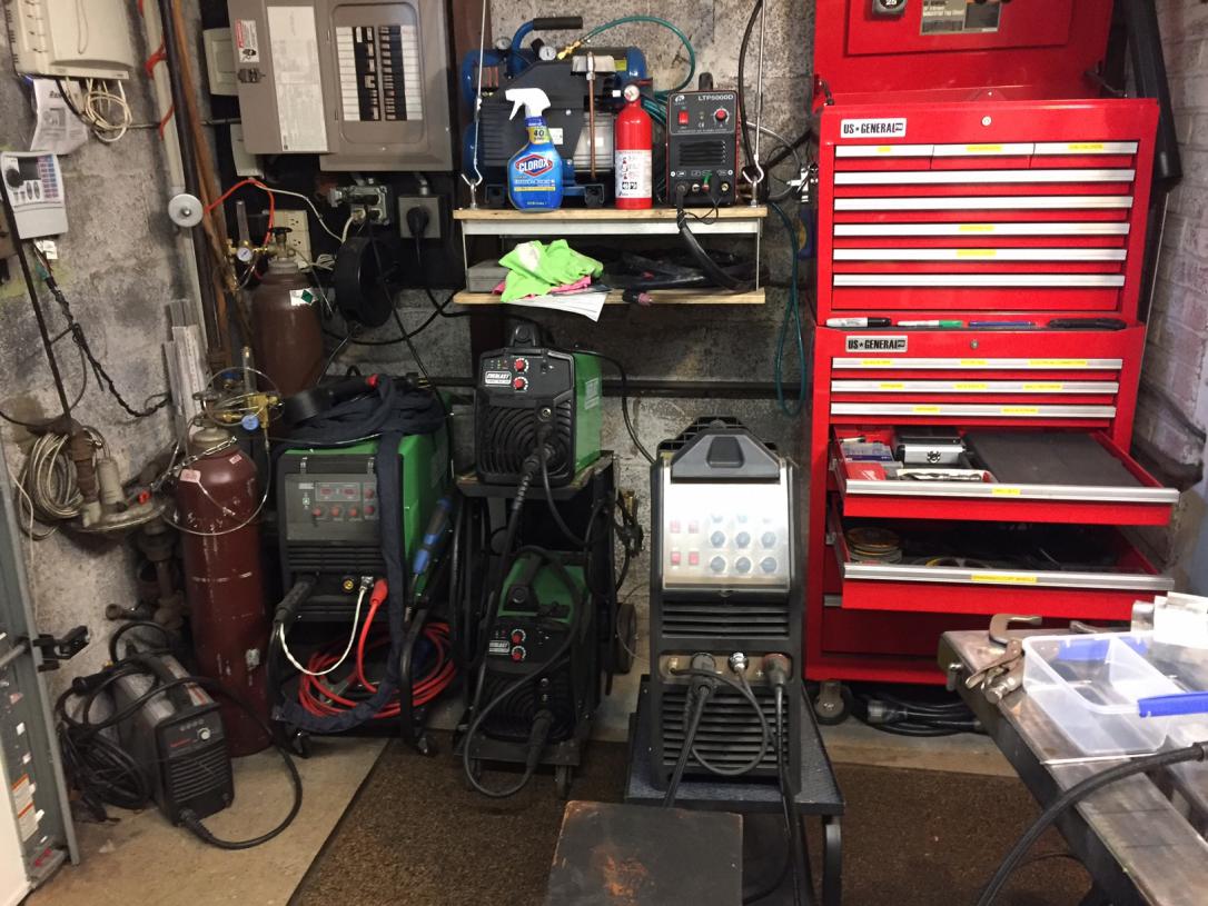

    I have the "old 205" and yes, I was told it is the new 210. It's light enough to move around. If you play with the spot and stitch functions, you can really get some interesting combinations for welding. It has a ton of power. I bought the matching (took some time) spool gun for it and it does 1/4" aluminum without any problems. You can easily over drive .035 wire and almost get it to spray without changing gas mix. I'm only a hobbyist, but I'm very happy with it.
    PeteClick image for larger version.
