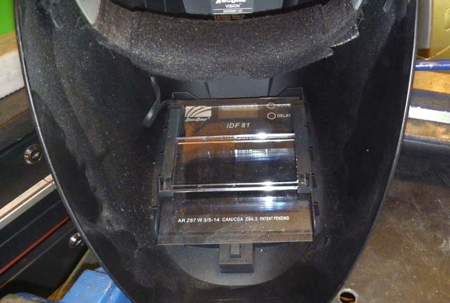

    Here's a little follow-up, Rambozo,
    I’ve recently gotten around to installing a 1.50 diopter/cheater in this lid, and in addition to using it along with some 1.50 reading glasses, there’s now a big improvement in my welding vision. I mean, with the reading glasses alone I’d have to keep 18” to 24” away to see in focus, but now I can get closer, which is a bit of a zoom-in ability for me, which is great.

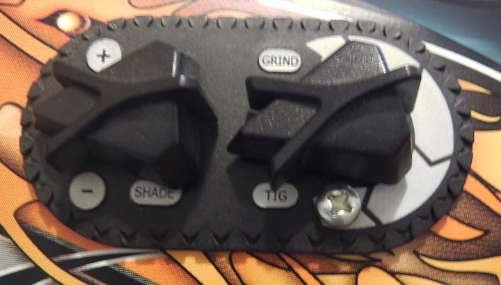

    Otherwise, the lid itself has has a tendency on a couple of occasions to have the remote sensitivity dial migrate to a less sensitive position over time or by fumbling with the other, forward-most remote Shade adjuster, which is non-problematic, since it’s a spring-loaded, jog mechanism. Of course, in low amp TIG welding, the sensitivity adjustment is important. So, I simply stuck a sheet screw near the more sensitive range of the dial to act as a nub stop, but which still allows moving beyond with some slight tension, if desired.

    So, with these minor modifications and additions, I’m really starting to get comfortable with this variable-shade lid.
