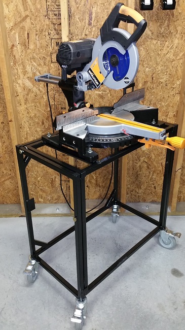

    I've been happy with the Rage 3 DB for the last two years. The slide action eliminates those clamp angle issues and you can quickly change angles with no tools or measuring.
ID:	13607   Click image for larger version.

    Well the saw was sitting on the porch when I got home today. The box looked like they dragged it behind the truck by the straps from the fedex hub. Cardboard ripped open, styrofoam sticking out, holes in the box. Gads, Well I took a couple pics, because I might need them. I opened it up and dusted off the shredded styrofoam. It looked pretty good. One bent foot, easily straightened. The auto closing blade cover, stuck in the open position. I messed with it a little and hit it with some WD40, then it started sliding properly. Better than I expected from the damage to the box.
    It did come with an angle block that fit on the vise. Eh, I will still use the ones I ordered. This only has one slot and it is a slip on tin one. The saw seems pretty good quality. Well when I get caught up on a few started projects I will post how I like it. It may be a little while.
