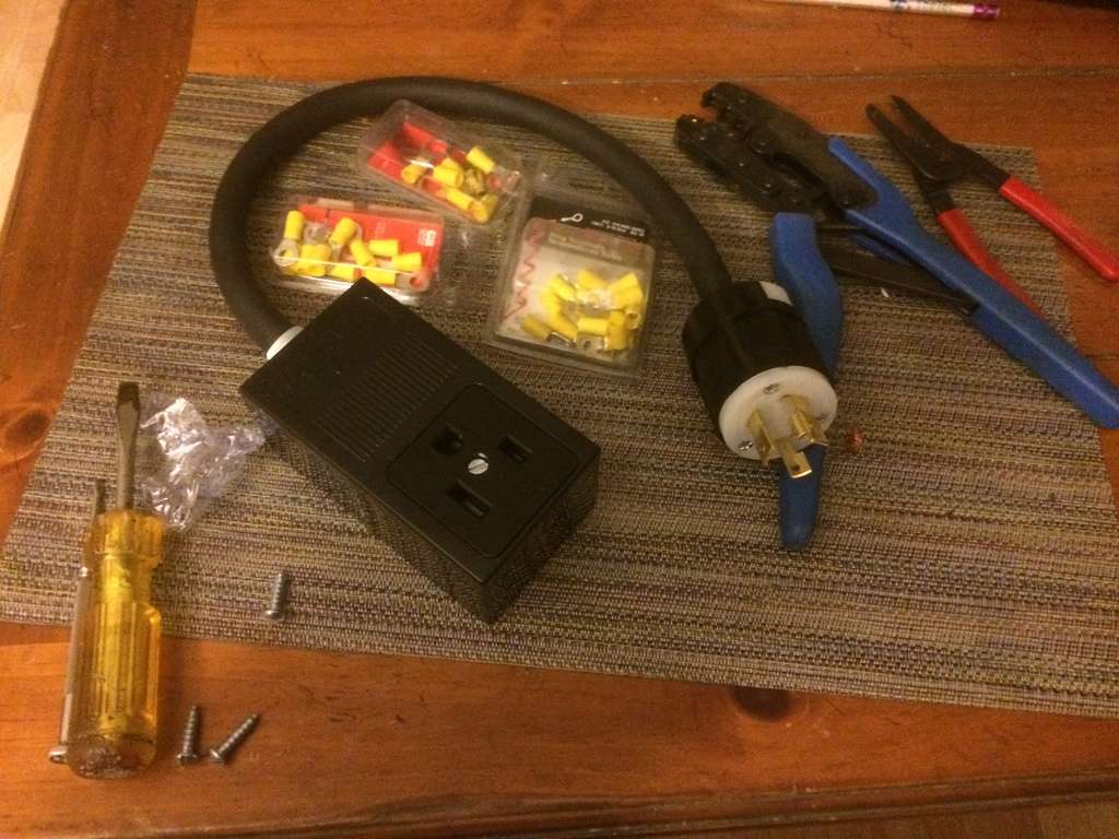

    The first thing after getting it was calling Mark at the recommendation of the office, I was curious about Max in-rush amps and/or getting a welder running on my 30 amp service.
    When I spoke to Mark briefly, he had a slight conniption fit when I mentioned cutting the plug off and replacing it with an L6-30P, and after thinking about it, I think he was right and I decided to go the pig-tail route, and came up with this. I now have power to the welder in my home shop.

    That looks like it should get the job done.

    There aren't any hidden menus on the 200T. It's an intuitive, easy setup. People keep asking us when the 201 or similar "knobbed" units are being deleted. They aren't. THere are different customer types and your post proves it. The membrane switches are quite rugged, and we've had no problems with them since their introduction in 2013. If anything, they are more reliable overall than the potentiometers. But, having knobs to make an easy setup is a valid viewpoint. Indeed, the 200T offers better stick welding features and better torch switch control. But if you don't need that, then the simplicity of the 201 is very attractive.
    As far as rewiring it goes and cutting the plug, as I said, we cannot recommend that or condone it. It's a modification of the welder that affects warranty. Preferably, you rewire your circuits to accept the National standard for welders, which we use. The solution you have is a will work solution. Make sure you have the black to black, and if you have a red wire in your wall, that you have the red connected to the white. Green to Green of course.
    Nice clean pig tail btw.
    And as you can see I did take your advice and make the pig tail. I crimped ends on the wires going into the NEMA 6-50R, and the twistloc is solid.
    BTW, I have ground run, not neutral to my 240v outlet. I have 2 hots and a ground. And yes, ground is connected to GREEN.
    Thanks for steering me that way Mark, I wasn't trying to be difficult but only get my welder working.
