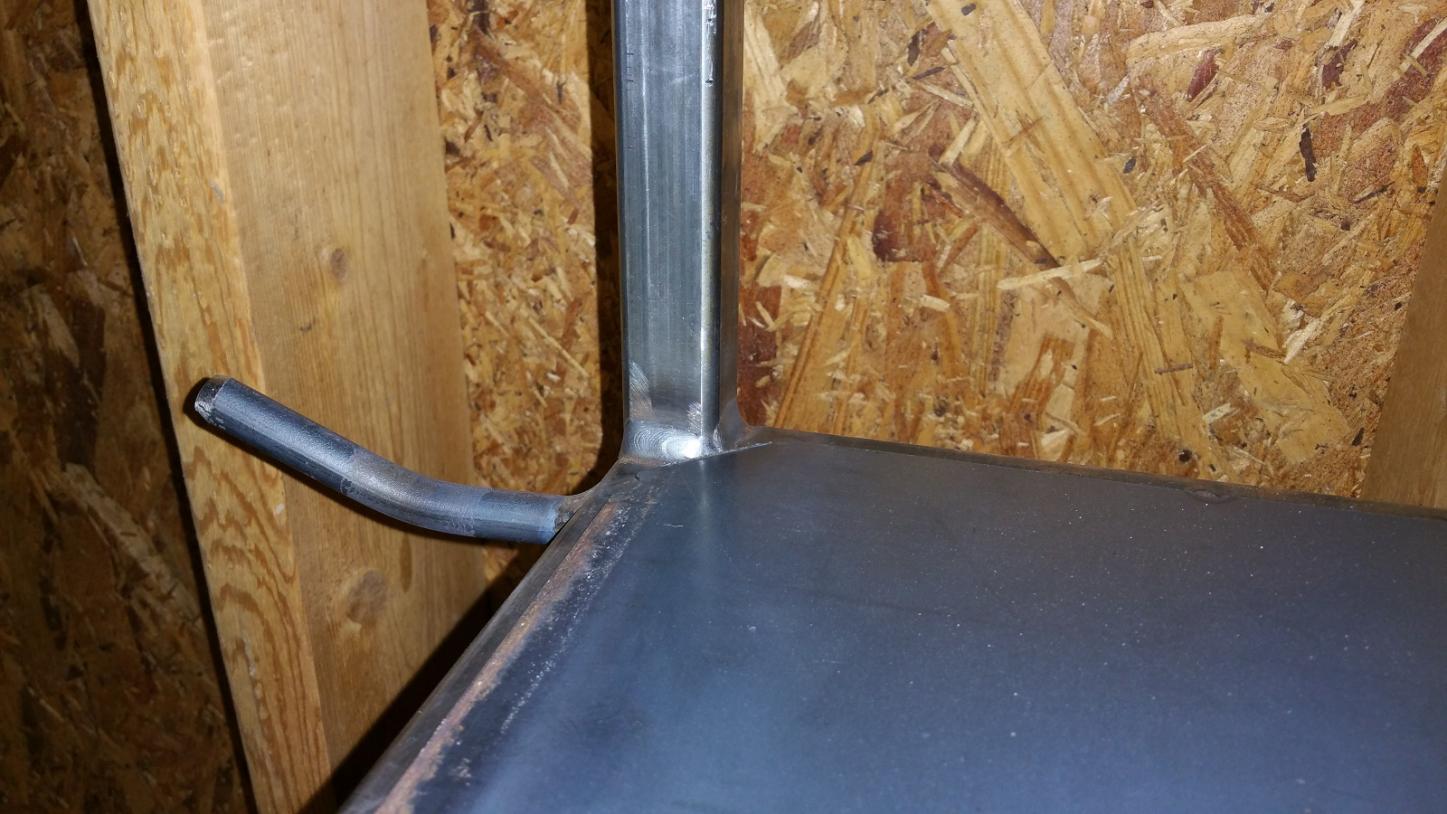

    My 250p has a spoolgun connection. As for settings it's the same for any mig. Set voltage for the metal thickness, start with the wire speed too high and turn it down while running a bead until it welds like you want. I leave my arc force around 7.
    The digital readout for wire speed does not represent the actual wire speed. It's just a reference number for repeatable setup. The readout switches to actual welding amps while welding. I like spray arc for 1/4" steel and thicker and use the regular 75/25 gas.
    Welds need to be horizontal since it's such a hot process. You can try it by setting your machine to 28v 300 on the wire speed. Keep reducing the volts by .5 and slowing the wire speed a little until you find the lowest setting to keep it in spray. You'll have to experiment with settings for different thickness steel and always use a tapered contact tip to avoid overheating your gun. The arc will be way more quiet than short circuit with no spatter at all. When you find a good setting for whatever, make a note of your settings.
    You can spray thinner steel also with more argon in the mix. I mixed my 75/25 and pure argon tanks with a tee connector to spray this 11ga square tube. Just keep testing and taking notes.
