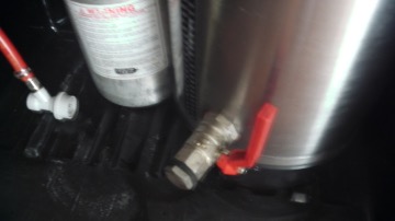

    I would like to learn to weld thin stainless steel, the journey will be long and hard. One day hopefully I will be able to weld a stainless steel ferrule onto my beer brew kettle. Like these pictures. The brew kettle is made from 20 gauge SS200. Thanks for your help.

    20 gauge takes a little practice, but as long as you have a machine with a good low end, it's not that hard. The tricky part is difference in thickness between the two parts. Torch angle becomes most important to control the heat input to each piece. Get some scraps of different thickness. Start with 1/8 and work your way down to 20 gauge or less. Then start mixing two different thickness pieces. 1/16 and .040" tungsten will help.

    I'm guessing that a unit with 10 amp starts would probably do it fine, even though 3 amps might be hard to beat. But I'd still think a specialized fixturing would be in order, with aluminum or copper backing around those areas that any thin sheet mates to the thicker stainless fittings. And I'd always tend to look for ways to have the bead on the inside of a vessel or at the lid or rim of the bulkhead fitting where it fits flush to a sidewall drilled hole, so you can avoid a fillet weld, which takes much more heat and may appear imperfect.
    So, yeah, if I were to want to do that stuff, I'd get a TIG unit, some cheap stainless tubing or pipe, along with some cast-off ss kettle or kegs, then practice on the best fit-ups, joints, and welding tactics.
    I mean, I use a basic kettle with no fittings for liquid and dry malt extract brews. But in all of he catalogs that I've seen for the more advanced kettles and other vessels, I don't think I've noticed any TIG welded bulkhead fittings. And that fitting that's shown, seems to have no secondary flange seat at the outer wall of the kettle, so that an outer weld with a modified fillet/lap weld might be quite feasible, especially with managing the heat and potentially having an aesthetically pleasant looking weld showing.
    So, maybe the silver solder route or whatever is the the more trodden path for that stuff is the smart and easy course. But please do let us all know if you manage to get it done well with the TIG process.
    Here's my threaded fitting to the Korney keg. Of course, it's only for a cold storage vessel under a bit of CO2 pressure. But, I believe I did attempt to TIG weld a much smaller, threaded fitting that took a simple cap, years ago, and it didn't go so well.
