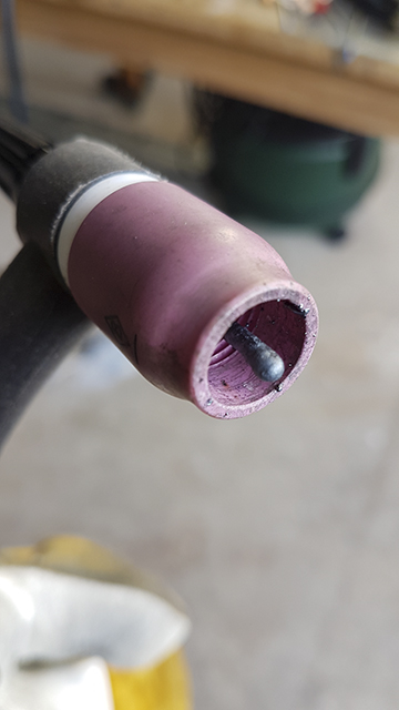

    Yes, that is galvanized or a coated metal.
    Yes, that is a horrible condition of your tungsten on the CIG weld and it is a form of ball and the tungsten is oxidized heavily. It may not be balled as much but that is poor condition.

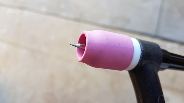

    Maybe another piece of the puzzle is that you could be starting with the tungsten stick-out being too far.
    About 1/4" is good.
    How about posting a photo of your tungsten newly dressed up in the torch.

    christian, i really appreciate your input, but i know all about stick out. i've read a lot about this, i also watched so many videos in youtube, specially that of jody, on how to tig weld. i've done stick, i've done mig, and done tig with my cigweld. i've finished a few projects around the house with my cigweld. i've also tried 1/4, a little bit more, i've tried the non-gas lens, gas lens, and i still get a balling up. it's like i've tried quite a number of permutation and combination just to know where i'm doing it wrong.
    btw, i also know that using with using a gas lens, you can have a little bit of a longer stick out as long as you up the flow a bit. but not to much because too much flow might also fireback in a certain way.
    but yeah, i will post a photo of my stick out later. i have a day job so i can only do this after office hours.

    here is #17 torch before welding showing the stick-out
    #17 torch after welding. looks clean, no balling up

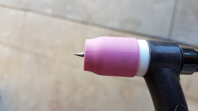

    #9 torch before welding

    looks like the galvanized aspect is the issue after the pure argon issue.
    thanks everyone for your inputs.
