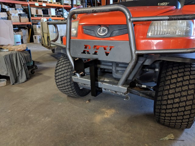

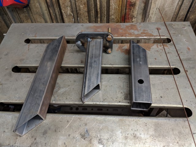

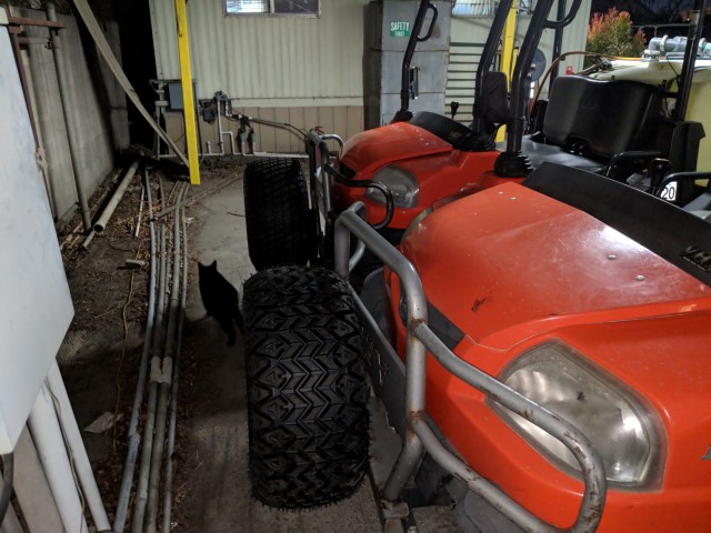

    Shook the rust off and actually did a little welding today. Made a couple of small parts for some UTVs. Cut up some .095" wall square tube and some .25" plate.

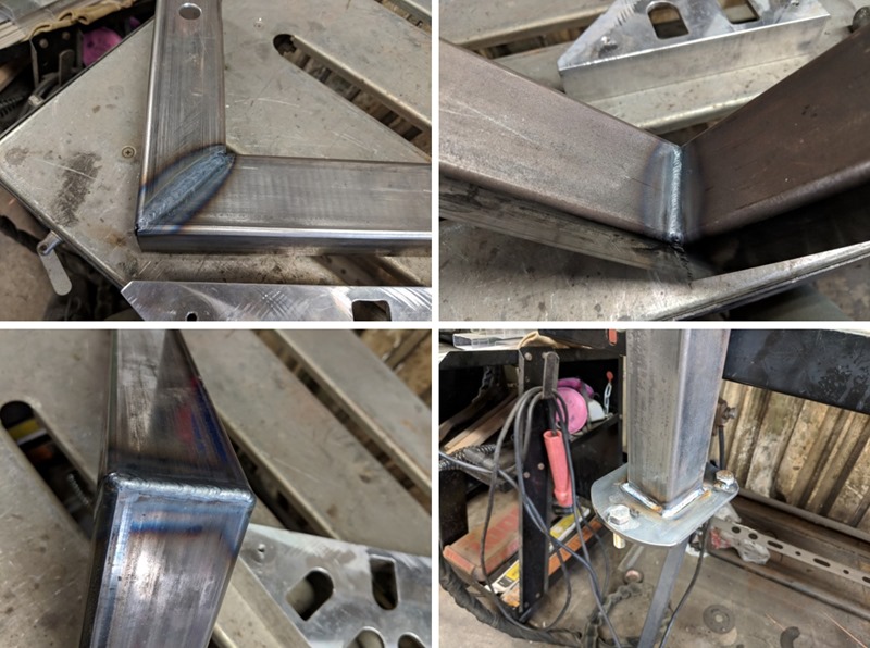

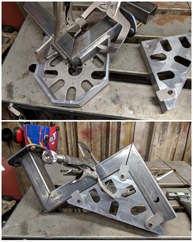

    Clamped up to tack with Fireball mini mega square. I'm finding these things pretty handy. They get into a lot of places where other clamping systems just don't fit. Still waiting to assemble new welding table, so I need something to hold things square on the portable table.
    Left a pretty good gap so I could sink the welds near flush on the sides and have most of the reinforcement on the inside of the tubing.That way just an optional kiss with a flap disc and ready to paint. Add a filet on the inside and round over the outside corner joint. Weld out the plate, too.
    A little paint.

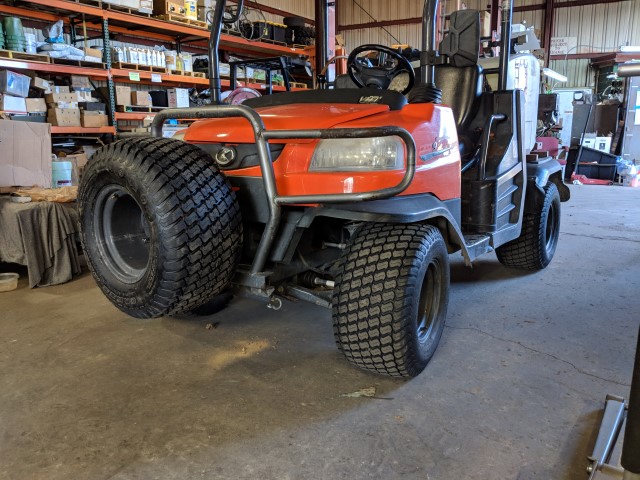

    And time to install.
    Inspector came over to check. Made one in 1.25" and one in 2" for the different front receivers. Still have one more to do, when that unit is around. Kubota changes things every few years, so none of these interchange. At least these two share a wheel hub pattern. The newest one changes that, too.
