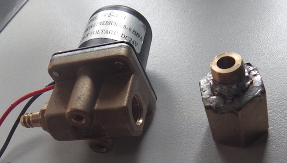

    I have a PP 256si and the back gas inlet twisted off and need a replacement, is this something I can get local (PA) or is this something that needs shipped back? It’s less than a year old?

    Depends on where it broke and if you can get the broken piece out.
    Yeah,
    I broke one off the back of my 210EXT.
    They're not robust at their neck, and I just replaced the whole solenoid with one that had NPT pipe threads, so that I could use other fittings with it that are easier for me to find, like a 45 degree elbow and quick connect fittings.

    The threads on that inlet threaded into the OEM solenoid didn't seem to be a metric thread, as I had a gal at a Fastenal store check it.

    So, while I was waiting for a cheap solenoid with NPT threads (only was $18-$20) to arrive to me, I was able to just solder the fitting back togather for keeping the welder ready for use.

    A lot of Chinese stuff is BSP or BSPP.
    Yeah,
    I was getting blank stares from Fastenal staff, if I recall, who were otherwise pretty savvy when identifying thread types for me.
    Everlast 210 EXT (2015)
    For those who don't know, BSP or BSPP is like npt (pipe thread) with no taper. It's supposed to seal with an o-ring but many Chinese manufacturers just put some sort of clear hardening sealant on the threads with no o-ring.
