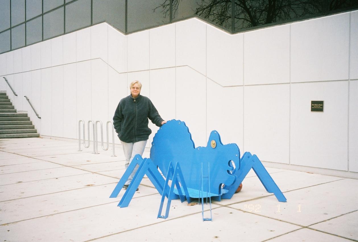

  15. Default photo of spider
    Here is photo of spider, I used my cut 60 to cut the 3/16" plate. Hope photo shows up...I will check and if it does not will try to attach again later.
