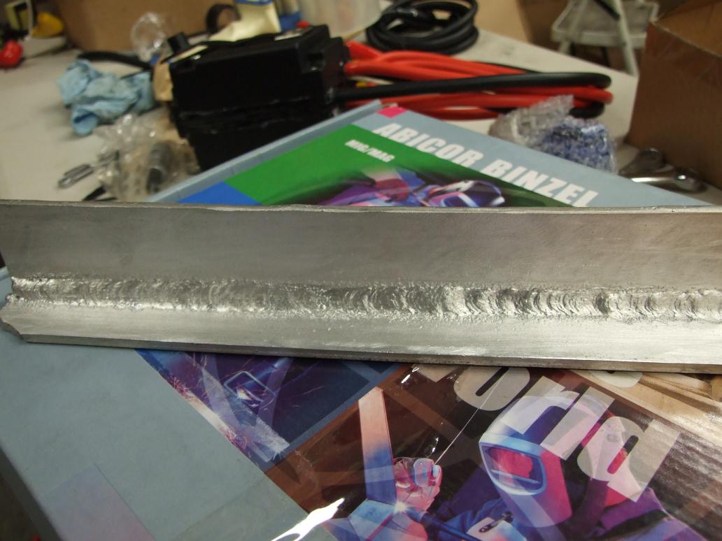

    Here is a picture showing the Spool gun with the IMG 200 doing 1/8" Aluminum.
    I have no experience with Spool guns and very little with Aluminum Welding Period. I can just get by doing Aluminum . Obviously a TIG weld would be pretty but this still looks Good for larger materials. Or at least i think so with my limited experience
    I think you get the general idea ,I did not really spend any time dialing it in just wanted to get a general feel .
