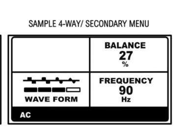

    Otherwise, Everlast settings for AC Balance is set for the cleaning action to the Electrode Positive (EP) percentage, e.g., 30% is pretty typical on any AC TIG unit. But many AC TIG makers have the AC Balance adjusted for the Electrode Negative percentage of heat input, e.g., 70% would be a typical setting on those machines, and would equate to the 30% (EP) setting on an Everlast unit.
    So, if you're used to a Miller unit and set an Everlast unit to 70% AC Balance, that will cause you to smoke a tungsten pretty quickly on AC.
