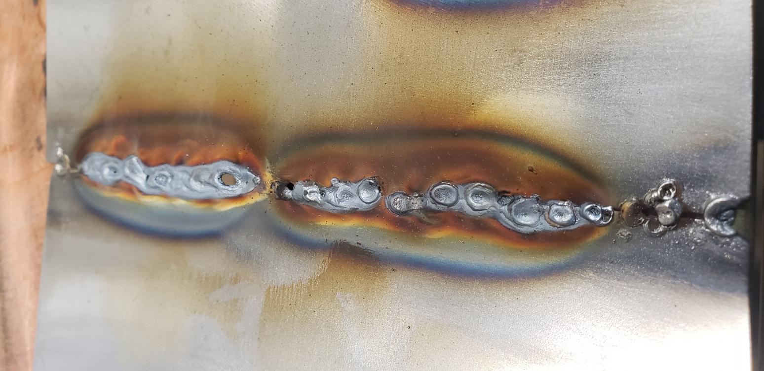

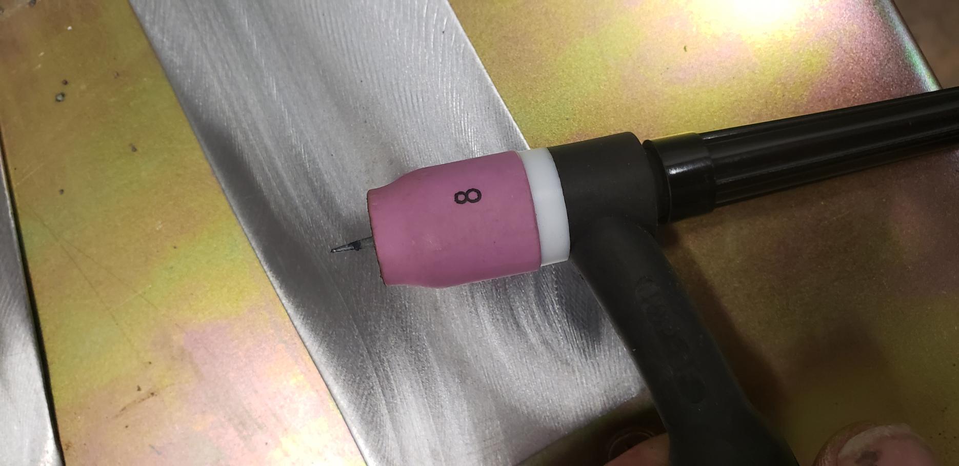

    Hello : I am new to Tig welding and have a DV 200 Everlast with a number 9 torch and a 3/32 tungsten sticking out about 1/2", gas lense and a number 8 cup . My argon is set to 15 cfm , pre-flow about 2 --post flow 4 . I am practicing on 18 gauge at about 40 amps . My practice parts are clean , but recently I'm getting a brown oxide on my welds and the tungsten seems to me burning up faster than beforeClick image for larger version.

    Looks like mixed gas, or your welder is too close to where you are welding, or it is contaminated gas.
    And clean that mill scale that isn't quite clean yet.

    I'd give yourself a little longer stick-out on the tungsten, so you can see the tip better to keep a tighter arc. Your cup size, your CFH setting, and the gas lens should all support that well enough.

    So I moved the welder 6 feet from my work and got a new bottle of Argon and same problem with the brown oxide . I hooked up the monster 26 torch that came with the welder and problem solved . I really like the size of the number 9 flex torch and would like to figure out were the air is getting in ? --I've already changed all of the consumable parts on it . could it be the hose?
    If you've over flexed the torch, you could have a small crack in the neck.
    Yeah,
    I used a #9 flex torch for a short time, years ago, but it did fail from a flexing crack pretty quickly, as I would often exceed its duty-cycle too.
    A generic #9 torch head is cheap, so just try replacing it, if you want to use that lightweight torch.
    I use a #17 flex torch almost exclusively now, but don't tend to flex it a whole bunch. So, it's a little heavier, with a better duty cycle, and holds up pretty well. Although I did smoke a #17 hose/cable, as I recall.
    So, it could be the hose/cable, or the torch head. That's easy to rule out one way or the other.
    And, if the hose/cable is still good, try getting a #9 and a #17 torch for it. The 17 will hold up better and still use the lighter hose than the #26 hose/cable.
