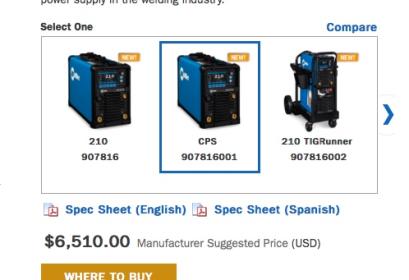

    So, if you're comparing a Dynasty 210 to the Typhoon 230, the Dynasty 210, with CPS, is about $6500, as a bare tool. That's right, no torch, no pedal, no nada! And that probably means it's about another $1000, after they're added, plus any shipping and sales tax.

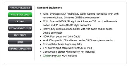

    Of course, Everlast includes a TIG torch kit and pedal at no charge. But, like my 210EXT came with the Typhoon includes two torches, one water-cooled and one air-cooled. And the air-cooled one is a 9 series, which is has a light duty-cycle for the torch and cable, so it's kind of odd that way, and you may want to upgrade to a 17 or 26 torch assembly for air-cooled TIG welding out-of-the-box.

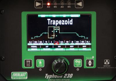

    Here's a photo clip of the Typhoon LCD panel layout. It's from a post by Mark Winchester at WW. The image shows larger at WW.
