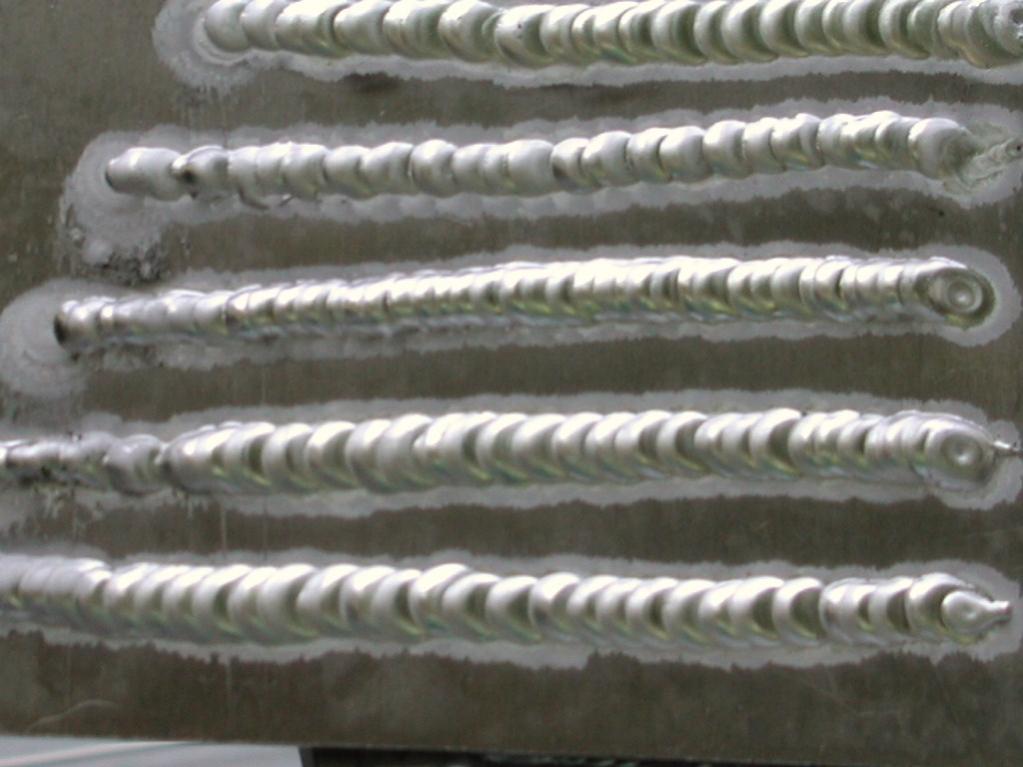

    Here are a few setting and pictures of a few welds I just did with basic 2T settings , the picture of the front panel are the setting that where used but I did vary the pulse time and rod size I used .062 and .125 5356 rod on a few of the welds near the bottom but basically the same settings .The picture I think shows 74 amps but it was on the low cycle when it took the picture . This was .125 thick 6061 aluminum , Main top amps where about 110 amps.The reason for the black marks was seems like the wind would just start to blow when I was starting up the welds. Sorry the pictures of the welds are not the best but my camera is older and does not like to get detail of the weld beads in good focus.And just noticed I posted the picture upside down , I am right handed so the start is where I was getting an erratic arc for just a second as well..

    Here are a few more pics but set in 4T mode basically the same settings that gives about 2 pulses a second maybey a touch slower like 1.5 pulses. Didnt need to change anything other than the 4T switch.. One picture was the backside with no rod just pulsing a square or something getting used to the pulse then in that picture was 1/16" rod bead. Then the second picture was different travel speeds and 1/8" rod..
