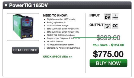

    The 185DV is price well right now, comes with the NOVA pedal, has free shipping now, and undoubtedly no sales tax for out-of-state buyers.
    Demo videos of it shows that the arc on it is very pleasant on AC, too.
