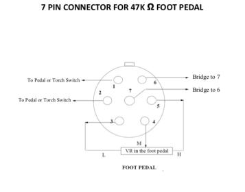

    Everlast unit manuals usually show a pin-out diagram for the pedal connector, and a two-pin contact switch may still need to utilize two more of the 7-pin slots to jumper to themselves if I recall correctly, which lets the machine sense that a pedal or contactor is installed.

    Anyway, here's the pinout for my 210EXT:

    Hmmm... that's brings up an interesting question and complicates my 2-wire to Pin 1 and 2 scenario. Thanks for posting!
    I can understand Everlast not wanting to provide complete wiring diagrams for their welders, but clear pinout drawings for the input connector (pedal or switch) for each model they make is a simple affair and would remove guess work. I can't find a 7-pin pinout diagram from my machine at all. It's certainly not in the manual I received but I will pull the cover and check inside.

    Thanks - tried a call but no one around so dropped an email. No pinouts in my manual, but did find them in other manuals and it's Pin 1 and 2 only.
