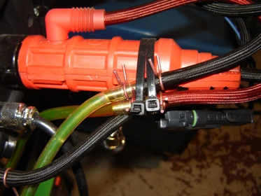

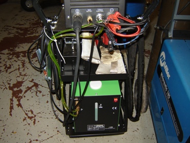

    Default Cooler setup
    Pictures of my cooler setup. The CK200 torch is installed, but the lines are the same size for the original torch (1/8" barb fittings). Not necessarily the best setup, but an example that works so far.

    Just for fun FYI, I have hooked it up backwards (not on purpose, lol) and welded some THICK aluminum and it seemed to cool just fine. But it is wrong, and is better to cool the head first. The big Traffimet 18 series is a forgiving sucker if nothing else! Great torch, even as i prefer a 20 series. But don't try to imitate the traffimet 18, and use your CK or any other 20 series water cooled torch, as an air cooled up X amperage! You will burn that sucker up with suprisingly low amperage. The one bummer about a WC 20 series if your only using a hose with city water ..... you HAVE to hook the hose up everytime you use it, unlike the dual use traffy.
