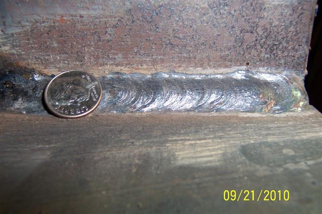

    Just a quick post too let Everlast know I am very pleased with my new PowerArc 200 inverter I have used this for about a week now and can find no faults! Lots of power for a great price!
    including a picture of 1st pass on a fillet weld done today on 1/2" to 1" plate,5/32 7018 at 165 amps EP
    Regards Bob

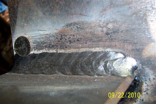

    wide weave cover 1/8 ,7024 ,140 amp, en

    I can not really answer the overhead . But i had a Customer in today and he specifically wanted to try out the vertical up weld and after burning a couple of rods in 6011 and 7014 he was very pleased with the performance

    Is this typical of the first pass thickness you can weld with the Power Arc 200?

    Yes, this is typical, though I'd suggest starting with a smaller rod and a smaller pass. Multiple passes are better.
