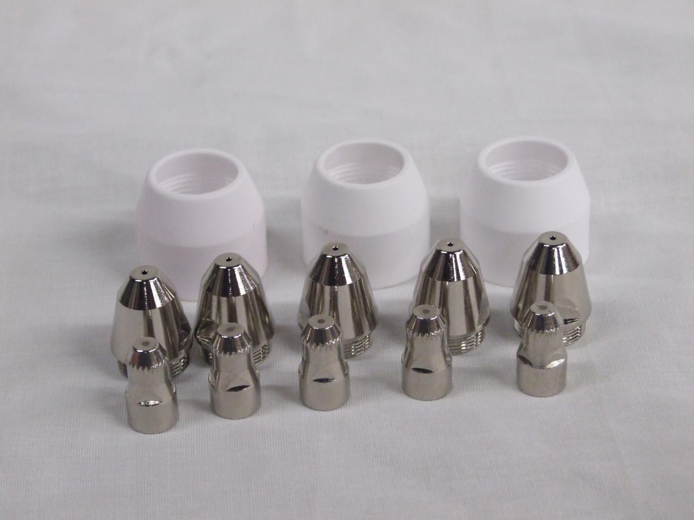

    My PP60 uses a slightly different torch to that of the US Model. You can see this more clearly when looking at the consumables each torch uses.
Name:	2010 cut 80 008.jpg
ID:	577   Click image for larger version.
Name:	2010 cut 80 007.jpg
