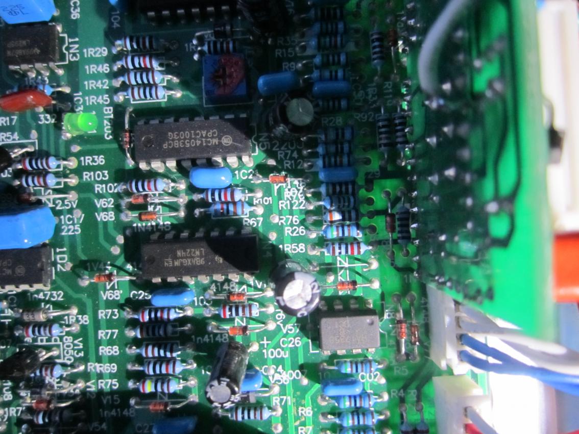

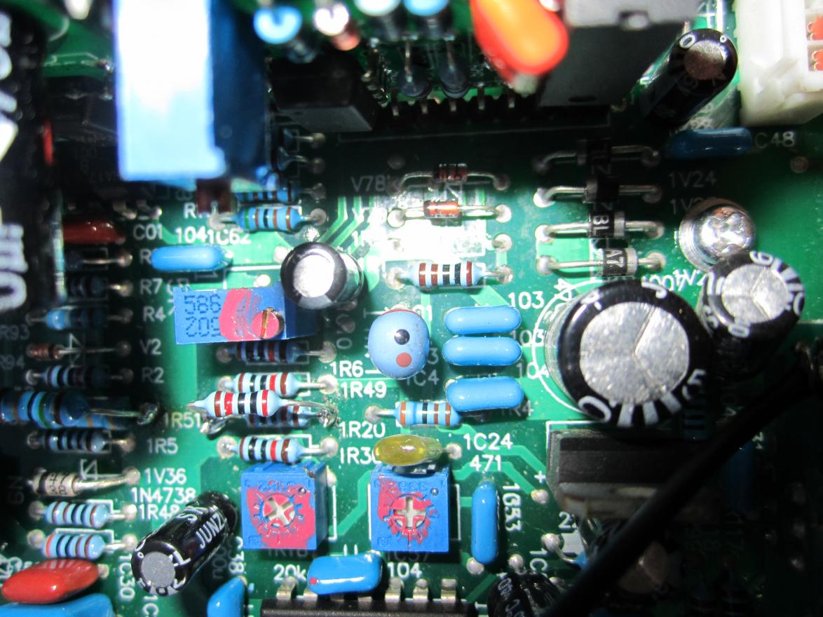

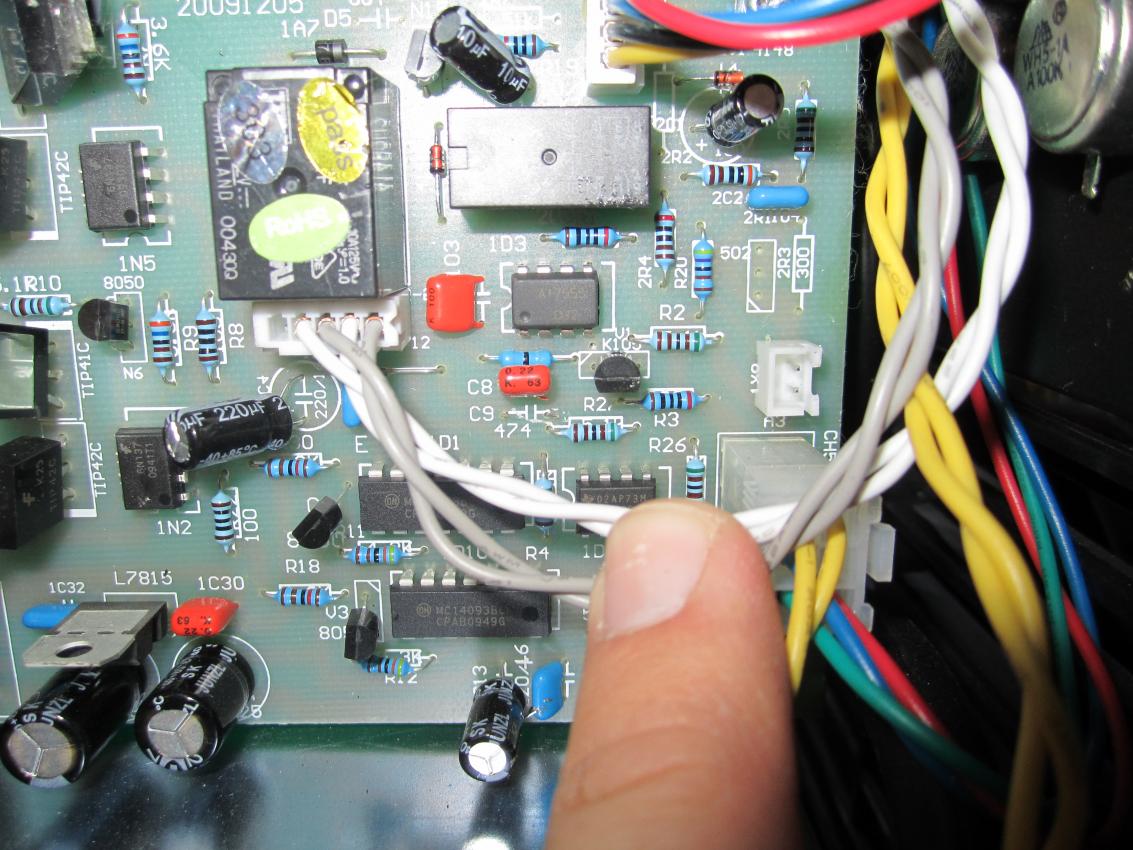

    Quote Originally Posted by Adambomb View Post
    Angular, did you still need some inside pics of my unit?
    If you get a chance... next time you have the cover off shoot me an e-mail (btp -> s16v.com) or call me (two five three 951-4712). There are three places inside my unit where components have been cut or are missing, so I'd like to compare.
    Diode V55 here on the main board up top:
    1K resistor (next to diode V79) on the main board up top, near the front:
    Capacitor C9 on vertical board mounted near front on left side (when looking at front panel):
    Thanks.
    Bradley
  4. #104
    Nov 2010
    Thousand Oaks, California
    83
    Sorry for the delay Bradley, but I replaced my rear cover today and checked my unit against the pics you provided. In each of the three locations, I had the same modifications. My unit functions perfectly now, so if you still have any issues it is not because of these particular mods. Click image for larger version.

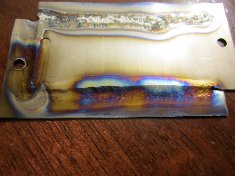

  5. #105
    Nov 2010
    83
    To illistrate how well the welder is working, here is 2 titanium coupons, .015" thick autogenously lap welded together. I'm looking forward to getting a back purge set up to do the welds properly.Click image for larger version.
Name:	improved auto ti weld.JPG
ID:	1209 I'm also looking forward to getting some titanium tig rod and making a custom Ti battery box for my old Kaw

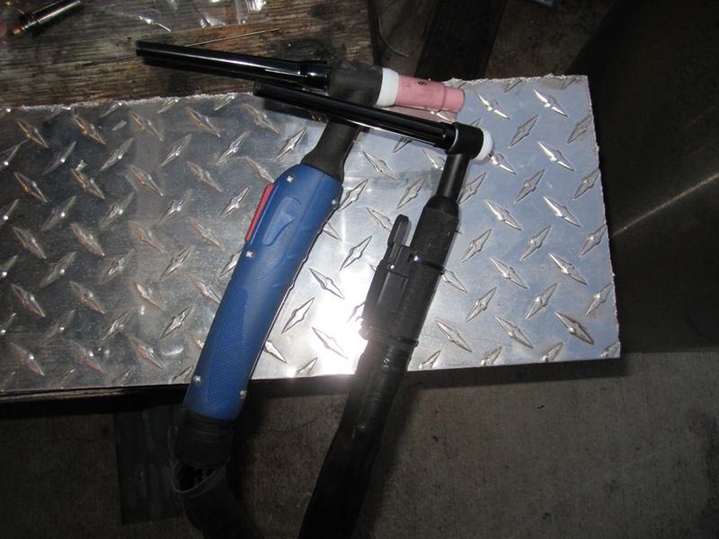

  8. #108
    Nov 2010
    83
    Smile
    YAY! My WP20 torch arrived today. I ripped it out of the package, and.....it's soooooo tiny! Here is the stocker next to the 20 torchClick image for larger version.
Name:	WP18 and WP20 torches.JPG

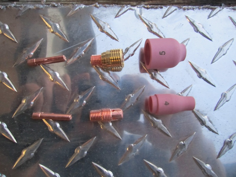

  9. #109
    Nov 2010
    83

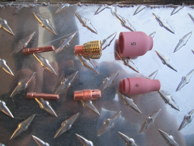

    OK guys, I ran into a small snag. When I went to assemble my new torch, I couldn't get the cup to thread onto the collet body. It seems there were not enough threads exposed past the insulator to even get the cup started on the collet body. This was with the collet body threaded on fully and seated in the torch head. Has anyone else had a similar circumstance with their everlast WP20 torch?

  10. #110
    Nov 2010
    83
    On top is the collet, gas lense and cup I just bought. On the bottom is the stock supplied parts. The gas lense and associated cup fits just fine, But the stock parts are a little iffy. I'm sure I must be doing something wrong, since I checked the stock collet body against one at the LWS, and they looked identical.Click image for larger version.
