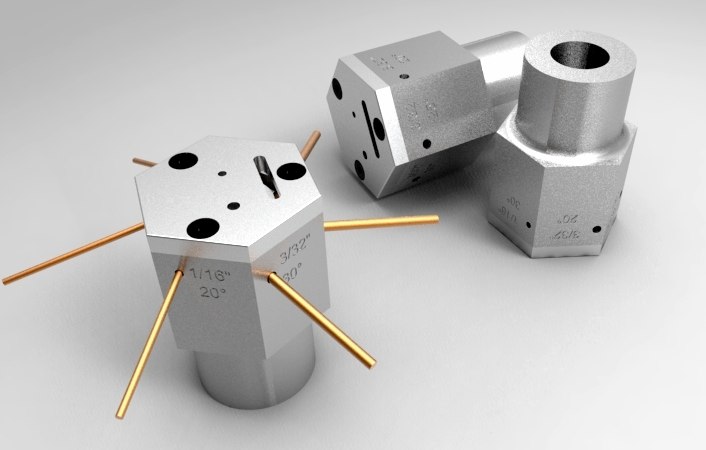

    There are a couple websites that sell inexpensive dremel type diamond wheels. I'll try to find the website again and post, but they had from 80 to like 320 grit diamond wheels.
    Eide
    PowerTig 225 LX
    Alright, that didn't take as long as I thought it was going to
    http://www.widgetsupply.com/page/WS/...nd-coated-disk
    No affiliation, just a happy customer.
    Here's a dremel attachment that I designed for these bits, works pretty well:
Name:	Hex Tungsten.jpg
    Eide
    PowerTig 225 LX
    Very Cool Eide! So what is the angle they are jigged to cut on the Tungsten? You wanna sell one? Either way, simple, basic, functional.

    Yesterday I went to Princess Auto and picked up a little "Jewelers/Jewelery drill" for $10. It has 4 collets that will accept .1mm up to 2mm.
    I think it's brilliant since I like cutting my tungsten down to 2''-3'' pieces and then grinding both ends. Having almost 30 pieces with both ends sharpened helps keep me in the welding groove when I don't have to get up and go sharpen a piece.
    I"ll post up some pics later.

    This is very nice Eide! Are they for sale?
    Quote Originally Posted by eide View Post
