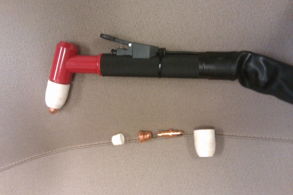

    OK I did some more testing.
    Replaced electrode, tip nozzle, swirl cup, and shield cup, no change.
    Noticed the spark gap glows blue before the start and goes off when the arc goes off.
    Re-adjusted the gap out to about 0.05" and there was no change.
    Adjusted the current control potentiometer and as the current is increased the arc gets brighter and turns on/off at a faster rate.
    As the current is decreased, the arc become blue in color but stays steady on - it will not cut it just scores the metal.
    Any ideas?
    Oh, and I made a mistake on my torch, the plastic is red and the shield cup is white, so I'm guessing it is the lower rated torch and not the SG-55...

    please take a picture of that torch , i think its older version 80a rated torch !

    I will shoot a picture of the torch and consumables today with my phone.

    Here you go...
Name:	Plasma torch.jpg

    That is one of the earlier 80A torches, it looks to be in good shape, but they are known for having issues. And what is happening does sound like a possible torch issue.
    If you can give me a call and I’ll help you inspect it, they seem to be more susceptible to damage from moisture in air line than others.

    This is a high frequency only torch/unit. The points should energize when the switch is pressed and a small "blue" arc should be seen for a split second before the arc is established. Dirty metal, rust, or other forms of oxidation are enemy #1 of regular HF units without a pilot arc. IF there is any rust, or paint present, a slight blue arc may be seen jumping around when you touch down. The cut may be lost as well if a bad patch is encountered. This is the downside of this type unit, if this is similar to what you are reporting. The points should deactivate when the torch arc is established. If the cut/arc is lost, then you will have to restart the torch manually.
  15. #35
    The metal is clean and new, the air is dry/clean and at more than enough psi/cfm, and the consumables that were replaced look like new - see the picture I posted...
    If the trigger is held, and the torch is making contact, the plasma turns on and off at a rate controlled by the current pot.
    It worked intermittently for a half dozen cuts r so and now it doesn't cut at all...

    Tolerances in the torch must be exact for things to work. IF it is consumables (and usually it is), no servicing will work. You can't just judge if they feel "tight". The real dimension is from the end of the electrode to the inside face of the nozzle. If that is off by a tiny, tiny amount, it will not work correctly. Any number of things could be the issue. The consumble height could be off slighly, or the shoulder machined too high or too low. The inside face could be a hair off as well. Just because it seats well, doesn't tell you much. The only way is to change to a newer batch of cons to try it out. The fact that changing the spark gap affected the starting tells me that you could have a clearance issue inside the torch head, making a longer gap necessary to create the spark.
