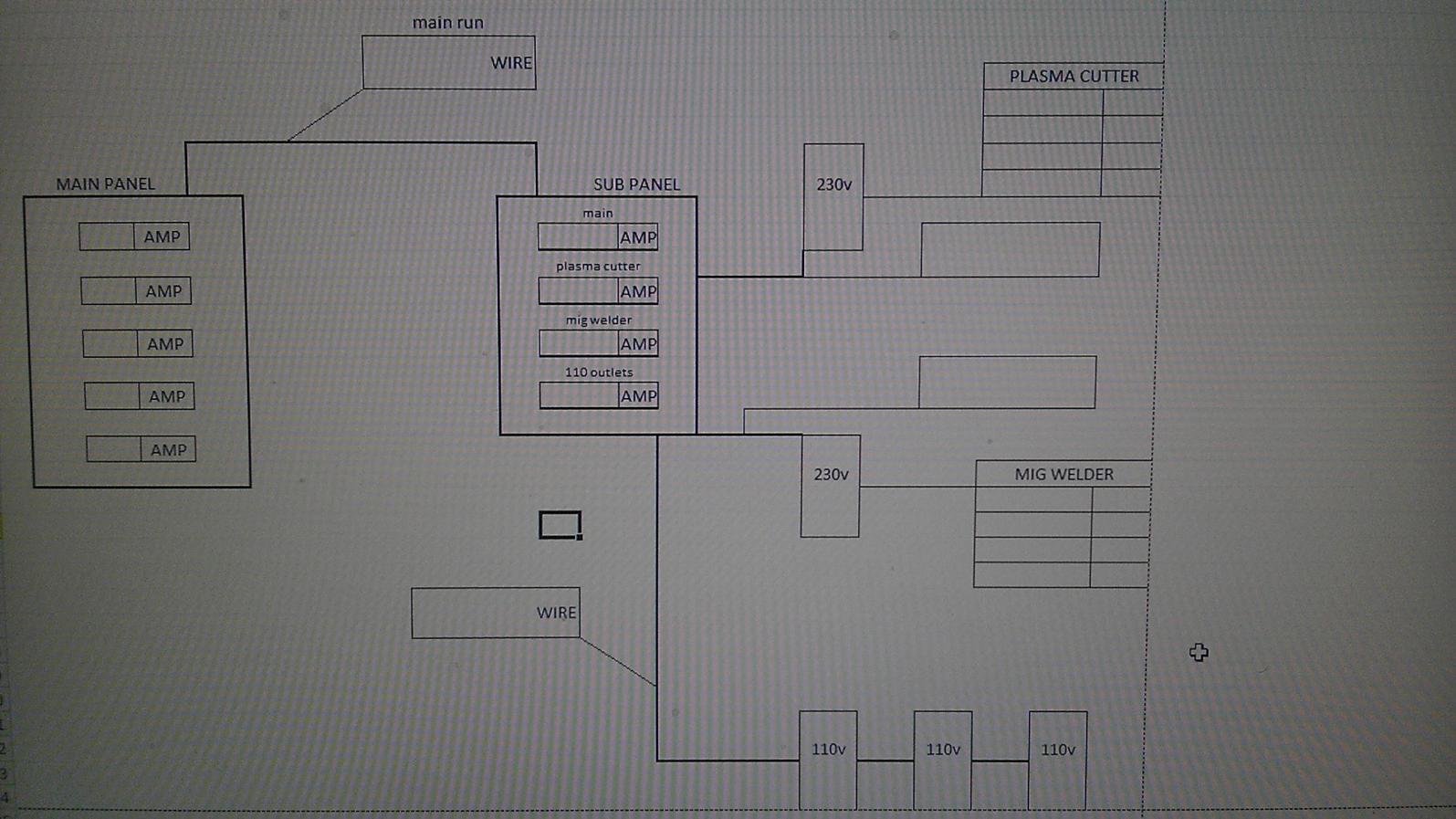

    First off Thank you tctop911 for your reviews and videos, they were invaluable in my decision making process. I just received my powerplasma 50 and cannot wait to play!
    My only hurdle at this point is wiring, i want what is best for my equipment and not burning my house down from an electrical failure would be nice to . What kind of set
    up do you guys have in terms of breakers and panels? i can wire up the stuff my self i would just like some input from anyone who has similar equipment and some experience.
    i slapped together a diagram of more or less what i had in mind. Please by all means tear it apart. Click image for larger version.

    Looks like you have a good overall plan. The specifics will depend on your local laws. Some places you can do the work yourself, then have it inspected and signed off, while other places you can't. For that type of job with a sub panel you will no doubt need a permit. You can check with your local building dept., as to what they require. What size will depend on the service you have. Right off I would say that if you have 200A service, I would go with a 100A sub panel. The sub panel will not typically have a main breaker, the main breaker for the sub panel will be installed in the main panel. The circuits for the plasma and welders should be 50 amp. Unless you are using them all at the same time, they might be able to share a circuit. A lot depends on the size of the building and where everything is going to go. Wire size is set by current and distance so what you need depends on your actual setup and your local codes. A local electrician can give you a quote for your various options.

ID:	8523Congrats on your new cutter Ed!! You are going to absolutely love the abilities this new tool will add to your arsenal. Like your first cordless drill/driver, once you get accustomed to it, you won't know how you did without it. Matched with a good welder and grinder, your creative opportunities are limitless.
    Your electrical plan looks fine to me as well. When I built my house, I had a 100 amp panel installed into my shop. I then finished wiring my shop myself, and as Rambozo suggested to you, I put in a 50 amp receptacle that I alternate between my cutter and welder with. I also made up about a 50 foot heavy duty extension cord to give me a little more flexibility in my shop and outside if I need to roll everything into the driveway for a repair.

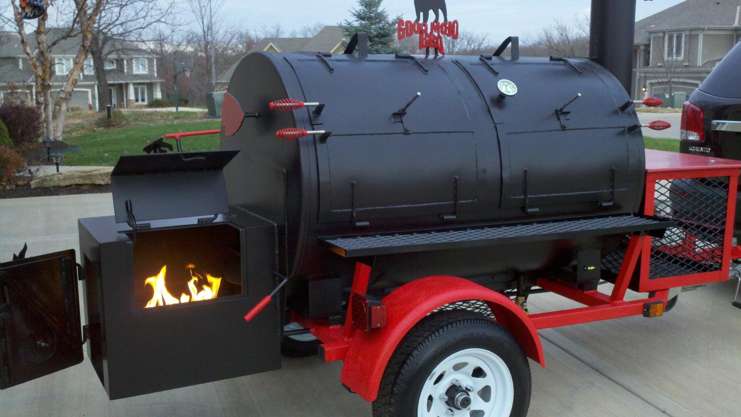

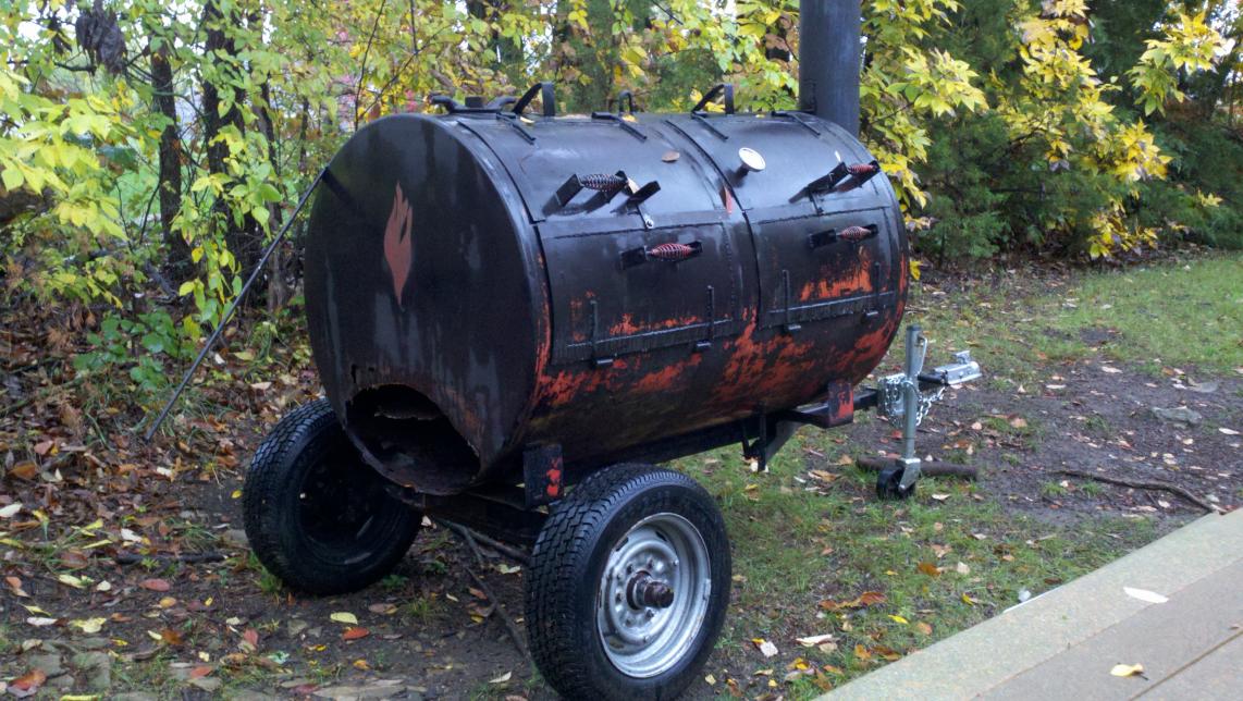

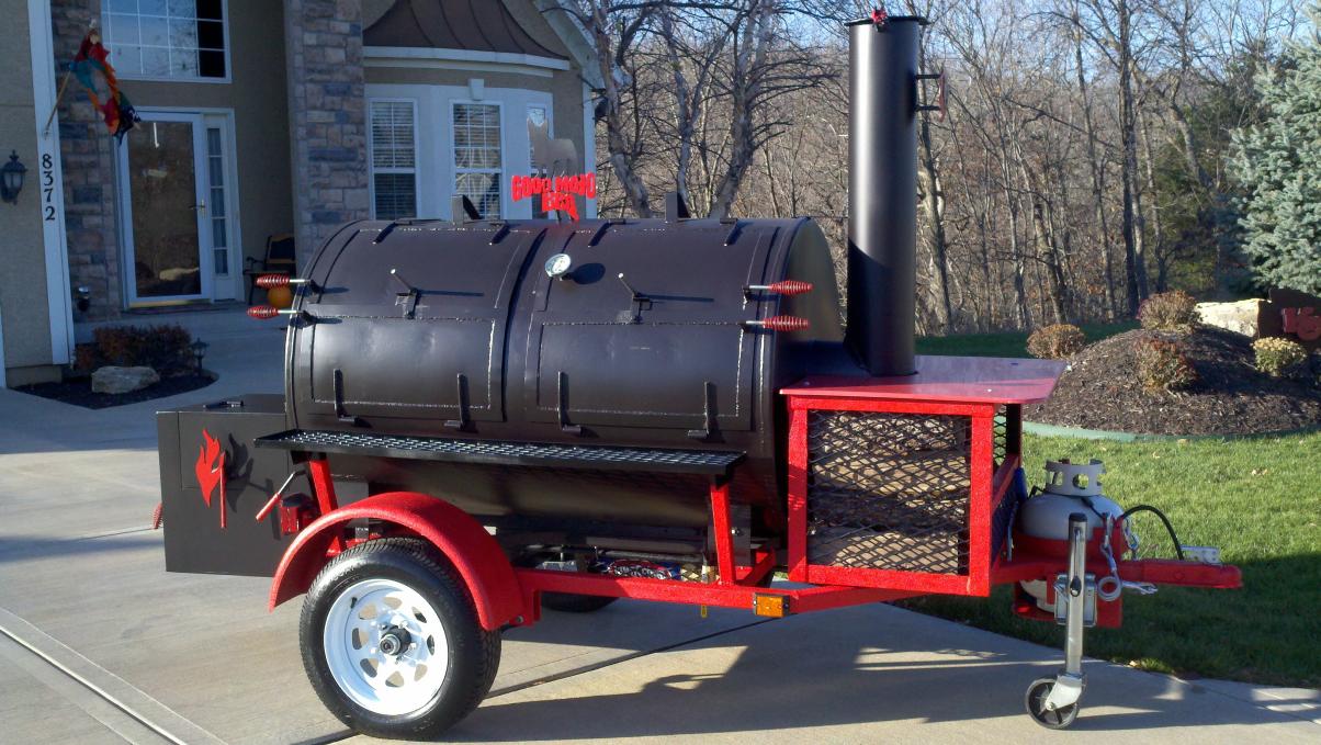

    I just put the finishing touches on my latest project that I couldn't have done without my plasma cutter. After 8 years of heavy smoking, my trailer smoker had finally rusted out at the end where the firebox attached. Since the smoke chamber my brother in law had originally built for me worked so well, I opted to completely rebuild the smoker to the way I wanted it. Tell me what you think! (Yeah, I know my Chiefs are sucking right now, but a true fan doesn't turn their back on their team when they're down...)
    With the exception of the preformed fenders and wheels, I fabricated everything else from stock steel. Hope you like it.

    Mighty fine project! I like the sign on the top, too! Did you put the fire on for the benefit of the picture or were you cookin' something up?
    I'm looking forward to getting a plasma cutter soon. After seeing your project, I'm even more stoked. Cheers!
