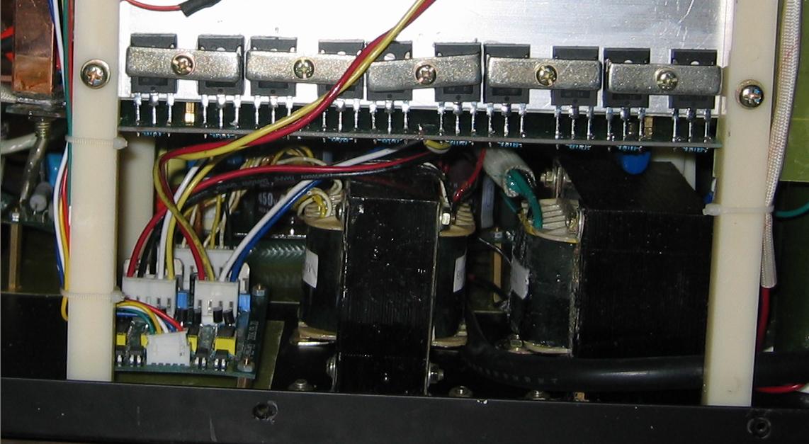

    I finally have time to install the transformer, but then it looks different.
    Left is the replacement, right is the one i took out of my machine.
    will the new unit work with my welder? after i splice the connector from my old coil or its it the wrong unit?
    Hey HoLun -
    I have this picture showing a couple transformers inside my 2007 Everlast Super200P.
    (I noticed that the one on the left looks similar to the replacement transformer that you showed a picture of.)
    Curiously, some of the wires on that transformer on my machine are just cut off (not used.)
    Let me know if you need help tracing any wires in the machine, etc.

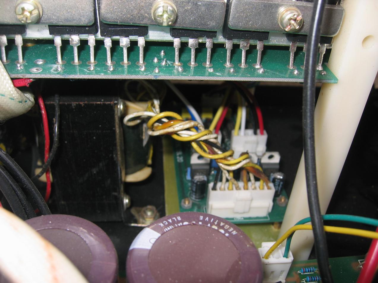

    Edit: I found this other picture as well (this is looking through the middle of the machine towards the outside at the transformer.) It shows the transformer's wiring harness. Maybe it will help you make sense of things.
